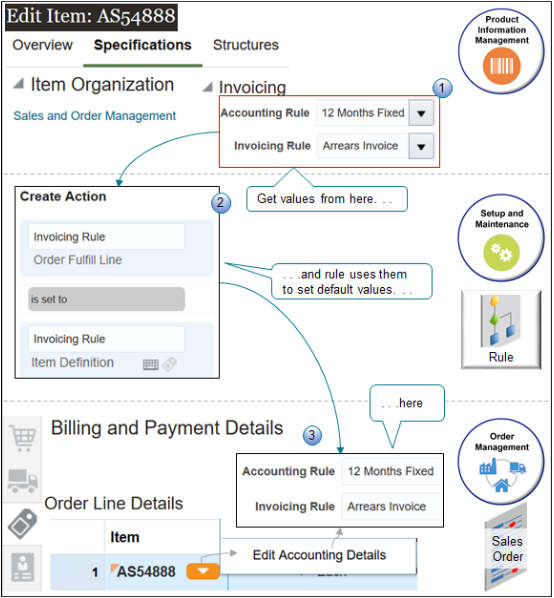

Get Values from Product Information Management and Use Them to Set Values on Sales Orders
Create a business rule that gets a value for your item from the Product Information Management work area, then use it to set the default value for an attribute on the sales order.
Here's an example of how it works.
What the Numbers Mean
Use the Product Information Management work area to set the values for the attributes you need to reference.
Use the Setup and Maintenance work area to create a business rule that gets the values from Product Information Management and uses them to set default values for attributes on the sales order in the Order Management work area.
At run time, use the Order Management work area to create the sales order and Order Management automatically sets the attribute values.
Here's the example pretransformation rule you will create.

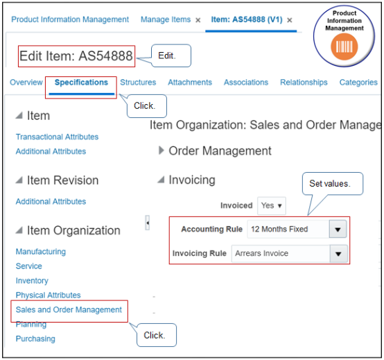

Modify the Item
Do it.
Make sure you have the privileges that you need to administer Product Information Management.
If you don't sign in with these privileges, then the Product Information Management work area won't display your product details and you can't do this procedure.
Go to the Product Information Management work area.
Click Tasks > Manage Items, then search for the value.
Attribute
Value
Item
AS54888
In the search results, click AS54888.
On the Edit Item page, click Specification > Sales and Order Management.
In the Invoicing area, set the values, then click Save
Attribute
Value
Accounting Rule
12 Months Fixed
Invoicing Rule
Arrears Invoice

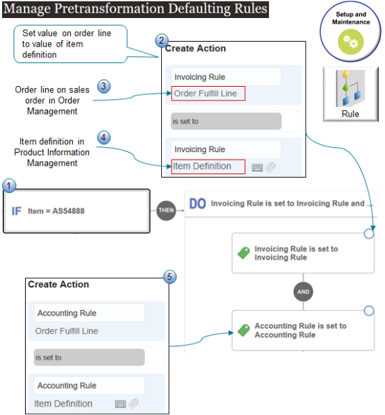

Create the Pretransformation Rule
Create the condition that asks whether the item on the order line is the AS54888.
Create an action for the Invoicing Rule.
Set the Invoicing Rule attribute on the order line on the sales order in Order Management to:
The value that the Invoicing Rule attribute contains on the item definition in Product Information Management.
Create an action for the Accounting Rule.
Do it.
Sign out, then sign into Oracle Applications with the privileges that you need to administer Order Management.
Go to the Setup and Maintenance work area, then go to the task:
Offering: Order Management
Functional Area: Orders
Task: Manage Pretransformation Rules for Sales Orders
Create a new rule.
Attribute
Value
Name
Set Default Values for Accounting and Invoicing Rules
Create the If statement.
In the If area, click New Condition.
In the Create Condition dialog, enter
item
, wait a moment, then click Item (Order Fulfill Line).Item (Order Fulfill Line) indicates that you're referencing the Item attribute on the fulfillment line of the sales order.
Click Search.
In the Search dialog, search for AS54888, click AS54888 in the search results, then click OK.
In the Create Condition dialog, click OK.
IF item = AS54888
Create the Then statement.
Click Then > Do.
In the DO area, click New Action > Set a Value.
In the Create Action Dialog, enter
Accounting Rule
, then click Accounting Rule (Order Fulfill Line). -
Click Attribute.
In the window that contains the text Attribute, enter Accounting Rule, then click Accounting Rule (Item Definition).
Accounting Rule (Item Definition) indicates that you're referencing the Accounting Rule attribute of the item in the Product Information Management work area.
Here's some pseudocode for the statement you just created.
Set the Accounting Rule attribute on the fulfillment line of the sales order to the value that the Accounting Rule attribute contains for the item in the Product Information Management work area
Click OK.
Invoicing Rule is set to Arrears Invoice
Add another action to the Then statement.
In the DO area, click And > Set a Value.
Invoicing Rule
, then click Invoicing Rule (Order Fulfill Line). -
Click Attribute.
In the window that contains the text Attribute, enter Invoicing Rule, then click Invoicing Rule (Item Definition).
Invoicing Rule (Item Definition) indicates that you're referencing the Invoicing Rule attribute of the item in the Product Information Management work area.
Set the Invoicing Rule attribute on the fulfillment line of the sales order to the value that the Invoicing Rule attribute contains for the item in the Product Information Management work area
Click OK.
Activate and publish your rule. For details, see Manage Pretransformation Rules.
