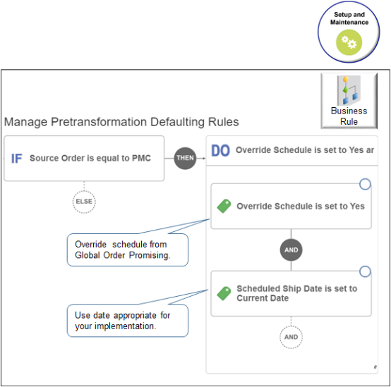

Set Default Values for Scheduled Ship Date
Set the default value for the Schedule Ship Date attribute on the fulfillment line.
You will create an example rule.
If the source order header includes PMC, then set the default value for Scheduled Ship Date to the current date.
Note
Use Visual Information Builder.
Enter Source Order (Order Header) when you create the If clause.
Enter values when you create the Then clause.
Override Schedule (Order Fulfill Line)
Scheduled Ship Date (Order Fulfill Line)
