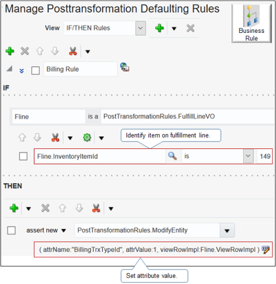

Create the If statement.
Fline is a PostTransformationRules.FulfillLineVO -
Create the And statement.
Fline.InventoryItemId is 149 -
Create the Then statement, then click Save and Close.
assert new PostTransformationRules.ModifyEntity (attrName:"BillingTrxTypeId", attrValue:1, viewRowImpl:Fline.ViewRowImpl) -
