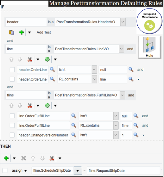

On the Manage Posttransformation Defaulting Rules page, create a new rule.
Add a check mark to the Advanced Mode option.
In the If area, set the conditions.
Code
Description
header is a PosttransformationRules.HeaderVODeclare the Header variable into the PosttransformationRules dictionary.
Get values for attributes of the order header that the orchestration process is currently processing from the header virtual object (VO), then store them in the Header variable.
line is a PosttransformationRules.LineVODeclare the line variable into the PosttransformationRules dictionary.
Get values for attributes of the order line that the orchestration process is currently processing from the line virtual object (VO), then store them in the line variable.
header.OrderLine isn't nullMake sure the order line contains a value.
header.OrderLine RL.contains lineDeclare the OrderLine variable into the rules language (RL) dictionary, then set the value of OrderLine to the value that the line variable contains.
This condition makes sure the OrderLine variable references the fulfillment line that the orchestration process is currently processing. It also makes sure you correctly declare the variable into the dictionary.
You use it to examine all lines in the sales order, not only the line that the current orchestration process instance is processing.
fline is a PosttransformationRules.FulfillLineVODeclare the fline variable into the PosttransformationRules dictionary.
Get values for attributes of the fulfillment line that the orchestration process is currently processing from the virtual object (VO) for the fulfillment line, then store them in the fline variable.
line.OrderFulfillLine isn't nullMake sure the line.OrderFulfillLine fact contains a value.
line.OrderFulfillLine RL.contains flineMake sure the line.OrderFulfillLine fact contains data from the fline variable.
header.ChangeVersionNumber isn't 1Proceed to the Then statement only if you're revising the sales order.
If the ChangeVersionNumber attribute on the order header equals 1, then the sales order isn't a revision.

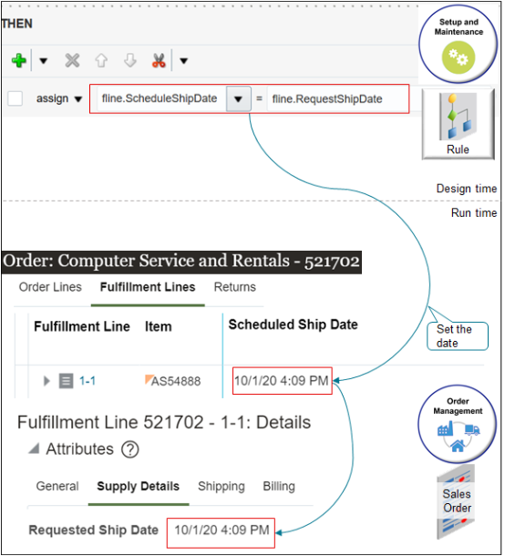

In the Then area, add an Assign action.
Code
Description
fline.ScheduleShipDate = fline.RequestShipDateSet the value of the ScheduleShipDate attribute in the fline variable to the value that the RequestShipDate attribute contains in the fline variable.

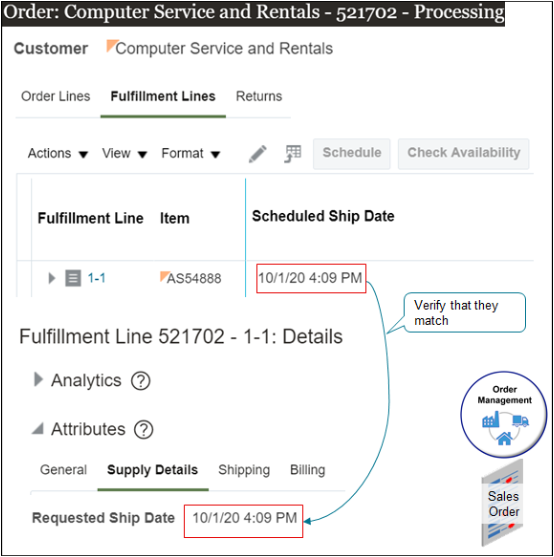

Revise sales order 521702, then submit your revision.
On the Order page, click Fulfillment Lines.
On the order line, examine the value of the Scheduled Ship Date attribute.
In the Attributes area, click Supply Details.
Examine the value of the Requested Ship Date attribute, and verify that it matches the Scheduled Ship Date.
