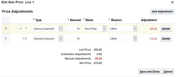

The Edit Sale Price dialog calculates adjustments in the same sequence it displays them. If you add more than one adjustment, then the sequence might affect price.
Assume you add these adjustments.
The dialog uses this sequence to calculate price.
Step |
Description |
Math |
1 |
Calculate percent discount. |
10% multiplied by $250 List Price equals $25 discount. |
2 |
Subtract percent discount. |
$250 minus $25 equals $225 Net Price. |
3 |
Subtract amount discount. |
$225 Net Price minus $10 equals final Net Price of $215. |

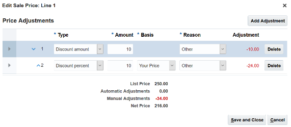

Assume you click the up arrow next to the number 2 to move discount amount to the top.
Step |
Description |
Math |
1 |
$250 minus $10 equals $240 Net Price. |
2 |
Calculate 10% discount. |
10% multiplied by $240 Net Price equals $24 discount. |
3 |
Calculate final Net Price. |
$240 minus $24 equals $216. |
