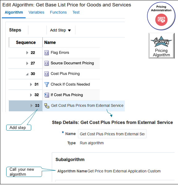

2. Modify a Predefined Pricing Algorithm
Modify the Get Base List Price for Goods and Services algorithm. This algorithm calculates cost plus pricing.

Modify the test that you use to determine whether to process cost plus pricing.
On the Edit Algorithm page, in the Sequence column, expand step 15 in the tree, expand the Cost Plus Pricing step, then click the step that has the value.
Attribute
Value
Name
If Cost Plus Pricing
Delete the content in the Condition window and replace it with this code.
Attribute
Value
Condition
false && NeedsCostPlus && finer('==== Invoking Cost-Plus Pricing ====') == null
Click Save.
Modify cost plus pricing.
Click the Cost Plus Pricing step.
Click Add Step > Composite Step > If.
Click the new step you just added and set the values.
Attribute
Value
Name
If External Costing Plus Pricing
Condition
Click Save.
Add the subalgorithm.
In the tree, click the triangle on the step you just added, If External Costing Plus Pricing.
This helps to make sure that the subalgorithm you add is a child of If External Costing Plus Pricing.
Click Add Step > Subalgorithm.
In the Step Details area, set the values.
Attribute
Value
Name
Compute Cost from External Systems
Algorithm Name
Get Price From External Application Custom
