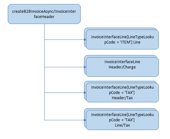

Figure 2
Figure 2 shows the structure of the transformed payload that's passed onto the application:
