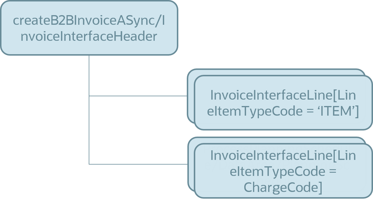

This diagram shows the structure of the inbound payload that's received from the inbound UBL-2.1-PEPPOL-Invoice-In message.
This diagram shows the structure of the payload that's passed to the application server for the UBL-2.1-PEPPOL-Invoice-In message.
This table shows where the data received in the predefined UBL-2.1-PEPPOL-Invoice-In message definition is mapped to in the application service.
