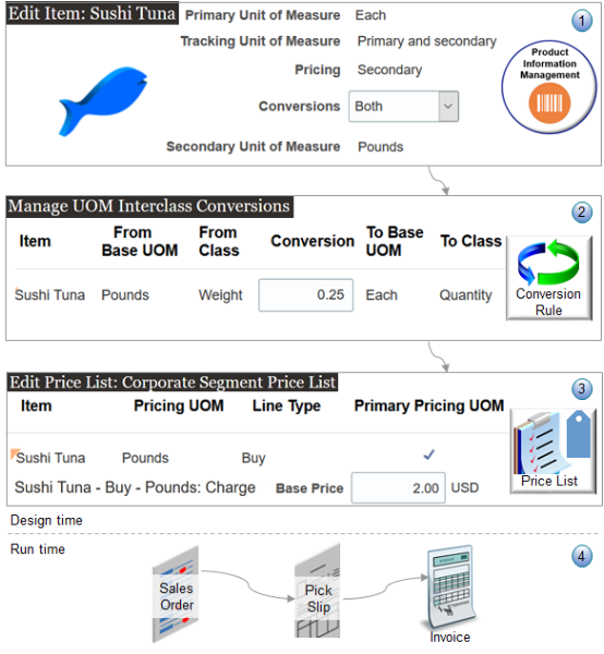

How You Set it Up
Assume you sell an item named Sushi Tuna. You price it by pound, not by each fish, so you need to price it in the secondary unit of measure. Sushi Tuna is a good candidate for dual units of measure because a tuna naturally varies in size, you typically sell each tuna as one fish each, but you price it by weight. You sell each tuna fish for a different amount because each one has a unique weight. You need to track the item in the primary and secondary UOM throughout the order fulfillment lifecycle.
What the Numbers Mean
  1. You specify details for the unit of measure when you set up the item in the Product Information Management work area. In this example, you set these attributes.
    Attribute
    Value
    Primary Unit of Measure
    Each
    Specify the unit of measure that you use to stock and sell and the item.
    Tracking Unit of Measure
    Primary and Secondary
    Specify how to track your on-hand balance.
    If you set it to Primary and Secondary, then you're telling Order Management that this item is a dual UOM item.
    Pricing
    Secondary
    Specify whether to use the Primary or the Secondary unit of measure to price the item.
    If you use Secondary, then pricing reprices the order line when you confirm the shipment.
    Secondary Unit of Measure
    Pound
    Specifies the unit of measure that you use to price the item.
  2. You use the Setup and Maintenance work area to create a conversion rule between the primary UOM and the secondary UOM. For example, convert 0.25 of the secondary UOM Pounds to 1 of the primary UOM Each. This tells Order Management how to convert from the primary to the secondary when it prices your tuna.
  3. You use the Pricing Administration work area to add the Sushi Tuna item to a price list, such as the Corporate Segment Price List. In pricing, you specify the Pounds UOM as the primary. This way, pricing will price it by the pound, not by each. You also specify the base price, such as 2.00 USD. So, you're charging $2 for each pound of tuna.
  4. Here's what happens at runtime.
    • You use the Order Management work area to create a sales order, add an item that uses dual units of measure, then submit the order.
    • Order Management creates and sends a shipment request to Oracle Shipping.
    • Oracle Shipping creates a shipment and populates the requested quantity and the secondary requested quantity according to your conversion rule.
    • You use the Inventory Management work area to create a pick wave, confirm the pick slip, confirm the shipment, then Inventory Management sends the confirmation to Order Management.
    • Order Management sends the order line to Oracle Receivables.
    • You use the Order Management work area to see that the order line status is Shipped, and also to examine invoice details.

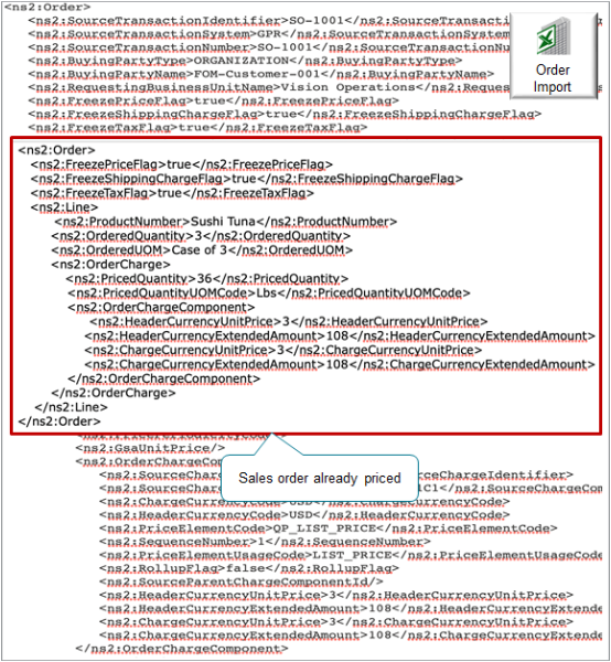

  • You can import through REST API, a web service, File-Based Data Import (FBDI), or Electronic Data Interchange (EDI).
Import Pricing
You can import a sales order that you already priced.
If the Pricing attribute in the Units of Measure area in Product Information Management contains:
  • Secondary. Your import must include the price details for the item's secondary unit of measure. If it doesn't, you'll encounter an error during import.
  • Primary. Your import doesn't have to include price details for the item's secondary unit of measure.
Order Management doesn't check to make sure that the Priced Quantity in the imported order matches the conversion between the quantity ordered in the unit of measure on the order line and the secondary unit of measure for the item. You must do this manually.
