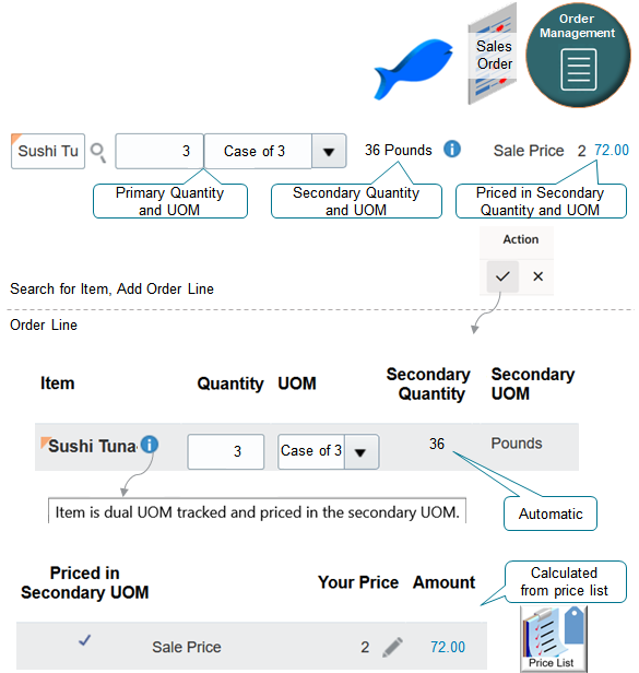

Create an order, search for your item on the order line, then add it to an order line.
Note
You use the order lineto search for the item. It displays the quantity and price for the primary and the secondary UOM.
You can't change the secondary quantity or secondary UOM on the order line, but you can change the primary quantity and Order Management will automatically calculate the secondary quantity and the amount.

Search for the Sushi Tuna item on the order line.
The order line sets the unit of measure to the primary, by default. It also displays primary and secondary attributes which makes it easy to see the conversion.
For this example, assume you change the Quantity to 3 and the UOM to Case of 3.
Attribute
Value
Quantity
3
This is the primary quantity.
UOM
Case of 3
The primary UOM of the item is Each. You can change it to any UOM that's in the primary UOM's class, such as Case of 3.
Secondary Quantity
36
The order line uses your conversion rules to automatically calculate the secondary quantity.
1 case contains 3 tuna.
1 tuna equals 4 pounds.
3 tuna multiplied by 4 pounds means each case weighs 12 pounds.
12 pounds for each case multiplied by the primary quantity of 3 equals a secondary quantity of 36.
Secondary UOM
Pounds
Sale Price
2
Line Price
72.00
Its the secondary quantity of 36 pounds multiplied by the unit price of 2 equals 72.00.
Information Icon
Let's you know that you're using dual UOM tracking on this item.
Click Add, then notice that the sales order adds the values that you set on the order line to the order line. Here are a few more details you should take note of.

Priced in Secondary UOM
Contains a value.
Selected. Pricing priced the order line according to the value in the Secondary UOM attribute on the order line. In this example, that would be Pounds.
Not Selected. Pricing priced the order line according to the value in the UOM attribute on the order line. In this example, that would be Each.
Order Management gets this value from the Pricing attribute that you set in Product Information Management.
