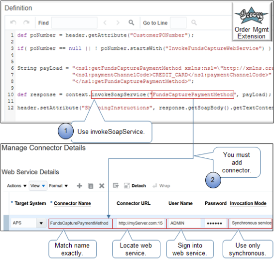

Use Method and Create Connector
extension that calls a web service
Note
  1. Use the invokeSoapService method in your extension to call the web service.
    You can call a web service in an Oracle Application or some other service that resides outside of Oracle Applications. You can also call REST API. For details and examples, go to REST API for Oracle Supply Chain Management Cloud, expand Order Management, then click Sales Orders for Order Hub.
  2. Set up the connector.
    You must use the Manage Connector Details page to set up a connector for the web service that you reference in your extension.
    Set these values.
    Attribute
    Value
    Connector Name
    Use the exact same name that you use in the extension. For example:
    invokeSoapService("FundsCapturePaymentMethod")
    For this example, set Connector Name to FundsCapturePaymentMethod.
    Connector URL
    Enter the URL that locates the web service address that you deploy on the system that resides outside of Order Management.
    User Name
    Enter the user name you use to sign into the web service.
    Password
    Enter the password you use to sign into the web service.
    Invocation Mode
    You must use Synchronous Service.
    For details, see Manage Connector Details Between Order Management and Your Fulfillment System.

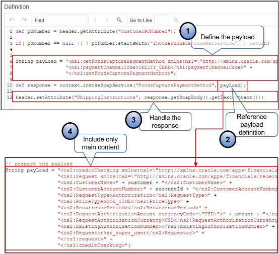

Create the Payload
payload that calls a web service
Note
  1. Create the payload. This example uses String payLoad to hard code the payload as a string. You can also use other techniques to meet your requirements, such as defining variables in the payload.
  2. Reference your payload definition in a parameter of the invokeSoapService method. This example references string payLoad.
  3. Use the getSoapBody method to handle the response that the web service sends in reply to your request. Your extension can receive the response, parse it, then extract the details it requires from the response.
  4. Create your payload so it includes only the main content. Don't include envelope or body details. invokeSoapService expects only the main content. It will add envelope and body details.

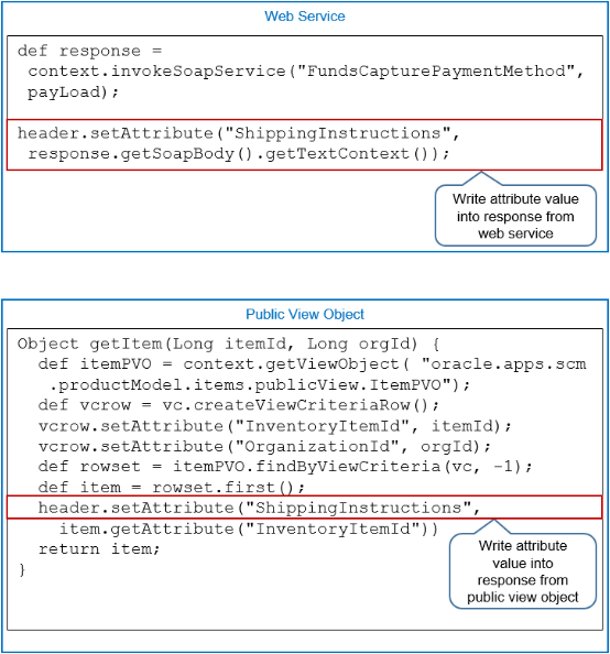

Inspect Payloads When You Use Web Services or Public View Objects
It might be difficult to examine the response from a web service or from the view criteria of a public view object. Use the setAttribute method during development to get values for the attributes that your code references, display them in the Order Management work area, then examine these values to verify your code returns the values you expect.
using the setAttribute method during development
For example, assume your extension references shipping instructions. You can use this code to write the contents of ShippingInstructions into the response from the web service.
header.setAttribute("ShippingInstructions", response.getSoapBody().getTextContext());
You can write the same data into the response from a public view object.
Make sure you convert your test code to log files or comment it ( // ) before you deploy to production.
You can also write a message to achieve a similar result. However, a message stops or pauses processing. Use a payload so processing can continue without interruption, and so you can view attribute values in the context of how they display in the Order Management work area, such as the Shipping Instructions attribute on the order line.
