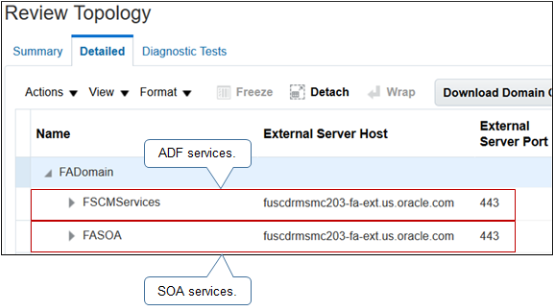

Identify Hosts and Ports
Identify the hosts and ports that you will use to access your payloads. Go to the Setup and Maintenance work area, then click Tasks > Review Topology. For details, see Identify Hosts and Ports for Order Management.
the Review Topology page.
For example:
  • If you use Oracle Application Development Framework (ADF), then use the host and port for FSCMServices.
  • If you use Oracle Service-Oriented Architecture (SOA), then use the host and port for FASOA (Oracle Applications, Service-Oriented Architecture).

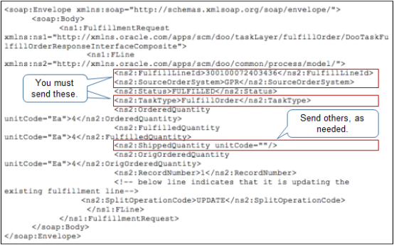

Set Up Payload for FulfillmentResponse Service
If you use Service-Oriented Architecture, then set up the payload for the FulfillmentResponse service.
Payload for FulfillmentResponse Service.
The payload that your fulfillment system sends must include these attributes.
<ns2:FulfillLineId>Id_number</ns2:FulfillLineId>
            <ns2:SourceOrderSystem>system_name</ns2:SourceOrderSystem>
For example:
<ns2:FulfillLineId>300100072403436</ns2:FulfillLineId>
<ns2:SourceOrderSystem>GPR</ns2:SourceOrderSystem>
where
  • 300100072403436 is the fulfillment line Id.
  • GPR is the source order system. Order Management typically uses the phrase source order to refer to an order that resides in an upstream order capture system. However, in this instance, SourceOrderSystem means any system that provides input details to FulfillmentResponse.
As an option, you can also send other attributes, such as ShippedQuantity, according to your business requirements.

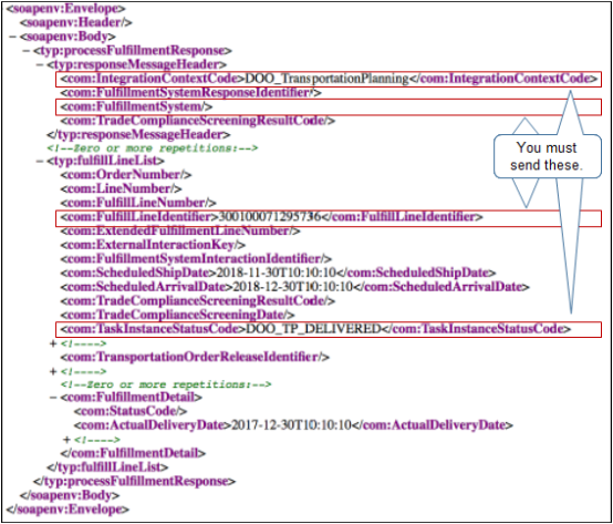

Set Up Payload for Order Fulfillment Response Service
If you use Application Development Framework, then set up the payload for the Order Fulfillment Response service.
payload for service Order Fulfillment Response.
<com:IntegrationContextCode>context_code</com.IntegrationContextCode>
<com:FulfillmentSystem/>
<com:FulfillLineIdentifier>numeric_value</com:FulfillLineIdentifier>
            <com:TaskInstanceStatusCode>status_code</com:TaskInstanceStatusCode>
For example:
<com:IntegrationContextCode>DOO_TransportationPlanning</com.IntegrationContextCode>
<com:FulfillLineIdentifier>3001000071295736</com:FulfillLineIdentifier>
<com:TaskInstanceStatusCode>DOO_TP_DELIVERED</com:TaskInstanceStatusCode>
where
  • DOO_TransportationPlanning is the IntegrationContextCode.
  • 3001000071295736 is the FulfillLineIdentifier.
  • DOO_TP_DELIVERED is the TaskInstanceStatusCode.
