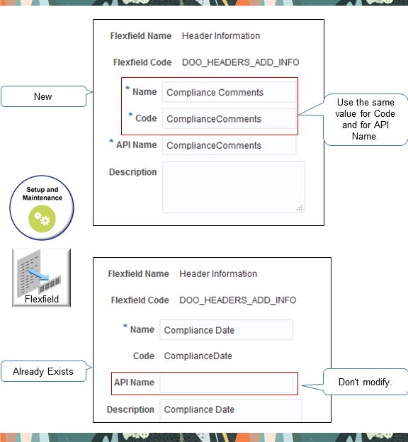

Create Segments and Contexts
If you:
| Create or Modify | Then |
| Create a new segment. | Use the same value for the Code attribute and the API Name attribute. This will simplify setup and maintenance. You use API Name throughout the setup, such as when you integrate with web services, business rules, business intelligence, and so on. You can't modify Code or API Name after you create the segment. |
| Modify a segment that already exists. | Don't modify API Name. Extensible flexfield logic examines API Name. If it's empty, then the logic uses the value in Code, so it isn't necessary to specify a value in API Name. If you do modify API Name, then your flexfield might fail with unexpected results at run time. |
Note
               Enter a unique code, name, and description for each segment. The Order Management work area doesn't display these values, so use whatever nomenclature is most helpful to you during setup and maintenance.
- You must not enable the Translatable option on the context. For details, see Set Up Extensible Flexfields in Order Management.

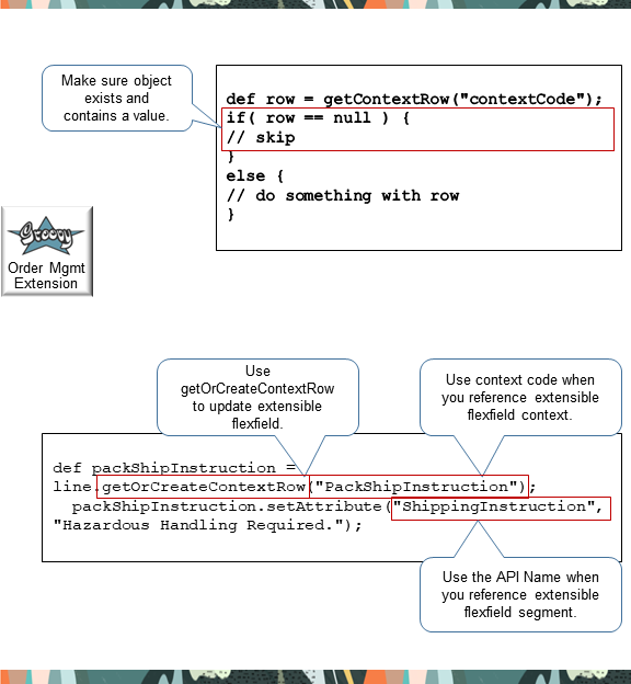

Use Order Management Extensions
         Note
               Include an If statement to make sure each context and segment that your extension references exists and contains a value. If you don't check for missing objects and empty values, then your extension might fail with unpredictable results.
               Use the getOrCreateContextRow method to create or update a value in an extensible flexfield. If the object doesn't exist, then getOrCreateContextRow creates it, so it isn't necessary to determine whether the object exists before you use this method to do an update. Use getContextRow to only get a row.
               Use Context Code when you reference an extensible flexfield context.
               Use API Name when you reference an extensible flexfield segment. If you don't specify API Name when you set up the extensible flexfield, then use Segment Code but with underscores ( _ ) instead of spaces ( ).
               Your Groovy code must traverse the context and the segment to get all data from the extensible flexfield. Here's an example that uses a whilestatement to traverse all data.def complianceDetails = header.getOrCreateContextRow("ComplianceDetails"); complianceDetails.setAttribute("_ComplianceReason", "This has been set by pre submit extension."); def lines = header.getAttribute("Lines"); while( lines.hasNext() ) { def line = lines.next(); def inventoryItemId = line.getAttribute("ProductIdentifier"); def orgId = line.getAttribute("InventoryOrganizationIdentifier"); def item = getItem(inventoryItemId, orgId); String hazardous = item.getAttribute("HazardousMaterialFlag"); def packShipInstruction = line.getOrCreateContextRow("PackShipInstruction"); if( "Y".equals(hazardous) ) { // get details for fulfill line context PackShipInstruction packShipInstruction.setAttribute("_ShippingInstruction", "Hazardous Handling Required."); } }

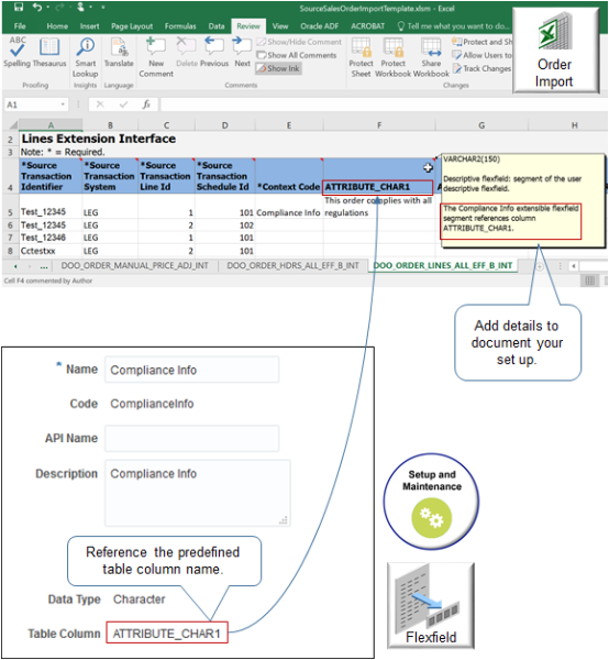

Use File Based Data Import
Use these guidelines when you use the order import template to import data for an extensible flexfield:
               Assign each segment's Table Column attribute so it references the correct column in the order import template.
               Use the DOO_ORDER_HDRS_ALL_EFF_B_INT worksheet to capture details for order headers.
               Use the DOO_ORDER_LINES_ALL_EFF_B_INT worksheet to capture details for fulfillment lines.
               Use columns, such as ATTRIBUTE_CHAR1, to capture details for each attribute.
               Don't modify worksheet names or column names. Instead, add a comment.
               Add a comment in Excel to document your set up.

This example illustrates how to set up the Compliance Info segment that references the ATTRIBUTE_CHAR1 column:

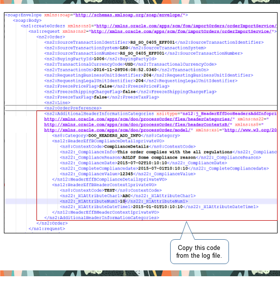

         Use Web Services
Add extensible flexfield details to the payload that Order Management uses to communicate with the web service:
               Use the web service named Receive Fulfillment Task Response Service with all task types. Use the DooTaskFulfillOrderResponseInterfaceComposite.
               Run the Publish Extensible Flexfield Attributes scheduled process.
               Copy extensible flexfield data from the log file that the scheduled process creates into the XSD file that contains your payload. Copy this data onto each object that needs extensible flexfield data. This approach helps to keep your channel system synchronized with your set up in Oracle Order Management.
               Use the import service from Application Development Framework (ADF). Don't use the SOA (Service Oriented Architecture) import service.
Here's an example payload that copies one section of code from the log file into the XSD file:
         See Guidelines for Using REST API, Web Services, and FBDI to Integrate Order Management.

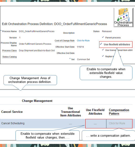

Manage Change
         Identify your requirements for change management. For example, figure out whether the orchestration process must compensate when you change the value in an extensible flexfield and the action to take when you compensate, such as schedule, call Oracle Receivables, and so on.
Set up the orchestration process differently depending on whether the value that it references changes any flexfield or a specific one:
| Compensate Value For | Enable the Use Flexfield Attributes option |
| Any extensible flexfield | On the header of the orchestration process definition. |
| A specific extensible flexfield | In the Change Management section of the orchestration process definition. Add it to the orchestration process step that references the extensible flexfield. Also set up a compensation pattern on this step. Use the compensation pattern to specify the action to do, such as Cancel, Create, Update, and so on, depending on the value that changes. Your set up can send an update when a single value changes and skip sending an update when other values change. This approach provides more detailed control regarding the compensation that you do. |
Here's an example compensation pattern:
pseudocode:
If segment3 changes, then cancel task x, and then recreate task x.
If segment4 changes, then do nothing.
If segment5 changes, then call an update service. For a detailed example, see Compensate Sales Orders That Change.
To ignore changes to all extensible flexfield values, make sure Use Flexfield Attributes for each step in the Change Management section isn't enabled.
Change management ignores each change that you make to an extensible flexfield's value at run time when it's on order header.

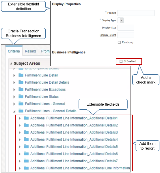

Modify Analytics
Oracle Transaction Business Intelligence (OTBI) provides analytic reporting. You can display extensible flexfield data in OTBI.
         Note
               Enable the BI Enabled option when you set up your extensible flexfield.
               Run the Import Oracle Fusion Data Extensions for Transactional Business Intelligence scheduled process. This process updates OTBI so it displays your extensible flexfields in area Subject Areas in OTBI. For details, see Overview of Flexfield Change Import.
               Add your extensible flexfields from Subject Areas into a report in OTBI.
               Here's the format that OTBI uses. Category_ContextFor example: Additional Fulfillment Line Information_Additional Details1where -
                     Additional Fulfillment Line Informationis the category.
                     Additional Details1is the context.

                  Can't update the value in the extensible flexfield on the fulfillment line.
                  Can revise the sales order and update the value in the extensible flexfield on the fulfillment line, but Order Management won't use the revised value when it processes the revision.
                  Can update an extensible flexfield on the order header regardless of the sales order's or the order line's status.
