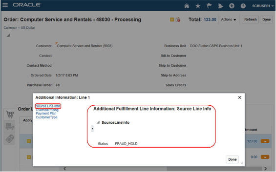

Test Your Set Up
Verify that the Order Management work area correctly displays your extensible flexfield.
Go to the Order Management work area.
Create a new sales order, then add an order line.
At the far right of the order line, click the down arrow, then click Edit Additional Information.
In the Edit Additional Information dialog, verify that it displays Source Line Info, and that it includes the FRAUD_HOLD status value that you noticed earlier in this topic when you examined the payload.
As an option, use SQL (Structured Query Language) to query the extensible_flexfield_example_sql.xml file. Verify the values that you specified in this topic. To access this file, get it from the Payloads and Files attachment that you downloaded earlier in this procedure.
Here are the values that your SQL should return.
Attribute
Value
SOURCE_ORDER_NUMBER
PMC-170113-001
ORDER_NUMBER
48030
FULFILL_LINE_NUMBER
1
CONTEXT_CODE
SourceLineInfo
ATTRIBUTE_CHAR1
FRAUD_HOLD
