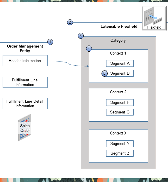

Use a hierarchy to specify how you want to display an extensible flexfield in the Order Management work area.
Here's the hierarchy:
hierarchy of an extensible flexfield
Note
  1. Order Management Entity. The top-level object in the hierarchy. You can specify one of these entities:
    • Header Information. Store details about the order header.
    • Fulfillment Line Information. Store details about the order line while Order Management processes the order line.
    • Fulfillment Line Detail Information. Store details that the fulfillment system provides when you don't typically store these details on the fulfillment line.

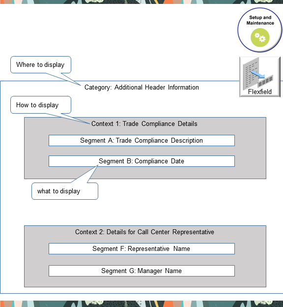

  2. Extensible Flexfield. Each extensible flexfield includes categories, contexts, and segments.
  3. Extensible Flexfield Category. Organize your data into a category according to attributes that contain similar business data. Specify where to display the extensible flexfield in the Order Management work area, such as on the order header. You can use only one category for each entity.
  4. Extensible Flexfield Context. Specify how to display the attribute. For example:
    • Specify criteria that determines the attribute to display.
    • Type of interface element that will display the attribute, such as text box or list of values.
    • Whether the Order Entry Specialist can view or edit the attribute.
    • Validation to do on the attribute.
    • Help text to display for the attribute.
    • Data type of the attribute.
    • Table column that stores the attribute.
    You can specify one or more contexts in each category.
  5. Extensible Flexfield Segment. Specify the attributes. An extensible flexfield segment is equivalent to a sales order attribute. Each context includes one or more segments that you can use to specify sales order attributes that store your data. You can specify one or more segments in each context.
Consider an example:
Note
  • Context1 stores details about trade compliance.
  • SegmentA references an attribute that stores the compliance description.
  • SegmentB references an attribute that stores the compliance date.
  • Context2 stores details about the call center representative who manages details about trade compliance.
  • SegmentF references an attribute that stores the representative name.
  • SegmentG references an attribute that stores the name of the person who manages the representative.

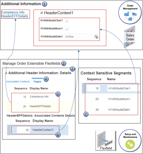

Here's an example that displays an extensible flexfield in the Order Management work area:
example that displays an extensible flexfield in the Order Management work area.
Note
  1. Additional Information. A dialog that displays when you click Actions > Edit Additional Information on the sales order header in the Order Management work area.
  2. Manage Order Extensible Flexfields. The setup page that you use in the Setup and Maintenance work area to set up an extensible flexfield.
  3. Additional Header Information. Specify the data to display and how to display it in Additional Information.
  4. Pages tab. You use the Pages tab to specify each area where you want to display your extensible flexfield. In this example, the Pages tab specifies one area named Compliance Info and another area named HeaderEFFDetails. The example displays HeaderEFFDetails in the dialog. You can specify one or more areas, and you can specify one more contexts in each area.
    In this example, the Pages tab specifies HeaderContext1 and HeaderContext2. However, for brevity, the screen capture displays only HeaderContext1. The Sequence specifies the sequence to use when displaying these contexts in the area, with 1 displaying at the top, 2 below 1, 3 below 2, and so on.
  5. Sequence and Display Name for page. Specify the name for each category that displays in the dialog. Sequence specifies the sequence to display the pages in the dialog. In the example, the Sequence is 10 for Compliance Info and 20 for HeaderEFFDetails, so the dialog displays Compliance Info first, then HeaderEFFDetails.
  6. Sequence and Display Name for context. Specify the name for each context that displays in the dialog. For example, HeaderContext1 organizes similar business data into a concise area of the dialog.
  7. Context Sensitive Segment. Specify one or more segments that display details for each attribute. The Sequence specifies the sequence to use when displaying segments in the area. You can specify these segments in each context:
    • 20 character segments. You can use up to 150 characters for each character segment.
    • 10 number segments.
    • Five date segments.
    • Five date and time segments.

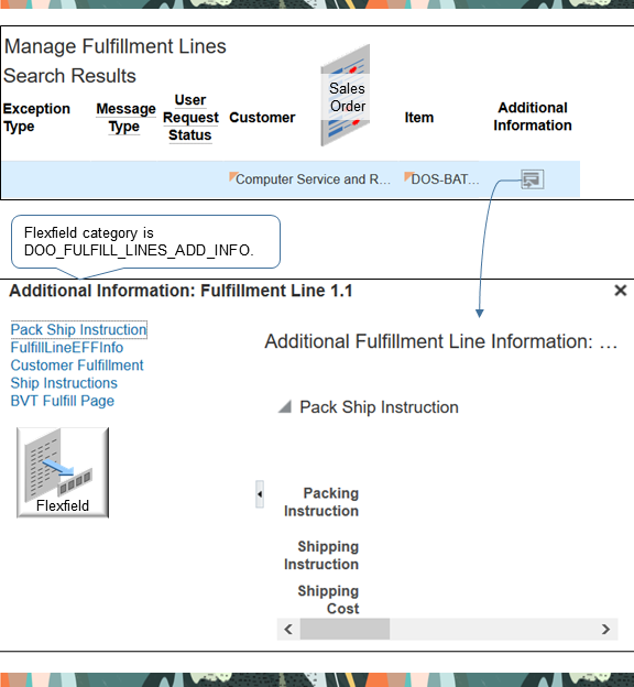

DOO_FULFILL_LINES_ADD_INFO
Fulfillment line
DOO_FULFILL_LINE_DTLS_ADD_INFO
General tab on the fulfillment line

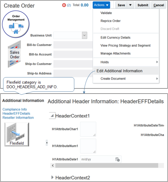

  1. Go to the Order Management work area, then click Tasks > Create Order.
  2. On the Create Order page, click Actions > Edit Additional Information.
    The Additional Information dialog displays each extensible flexfield you create that references the DOO_HEADERS_ADD_INFO flexfield category. For example, HeaderEFFDetails is an extensible flexfield.
    dialog Additional Information that will display each extensible flexfield

  7. On the Overview page, click Tasks > Manage Fulfillment Lines.
  8. On the Manage Fulfillment Lines page, search for your sales order.
  9. In the search results, scroll to the far right, then click Additional Information.

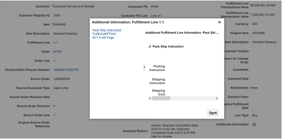

    The Additional Information dialog displays the extensible flexfield you create that references the DOO_FULFILL_LINE_DTLS_ADD_INFO flexfield category. For example, Pack Ship Instruction is an extensible flexfield:
    dialog Additional Information that will display any extensible flexfield you create that references flexfield category DOO_FULFILL_LINE_DTLS_ADD_INFO
  10. In the Fulfillment Line Details area, in the Attributes area, click General, scroll down, click Additional Information, then notice the dialog:
    example of dialog Additional Information that will display any extensible flexfield you create that references flexfield category DOO_FULFILL_LINE_DTLS_ADD_INFO

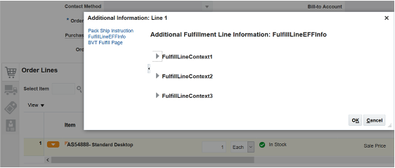

Here's an Additional Information dialog that displays each extensible flexfield that references the DOO_FULFILL_LINES_ADD_INFO flexfield category. For example, FulfillLineEFFInfo is an extensible flexfield.
Additional Information dialog that will display each extensible flexfield you create that references flexfield category DOO_FULFILL_LINES_ADD_INFO

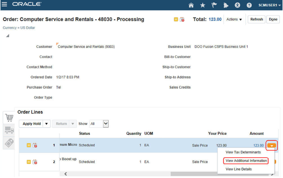

Order Management displays each extensible flexfield in an Additional Information dialog. Here's an example that displays the View Additional Information menu item on each order line on the Order Lines tab:
example dialog that displays a View Additional Information menu item

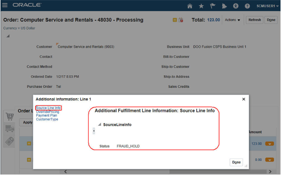

In this example, View Additional Information allows the Order Entry Specialist to access the Source Line Info extensible flexfield.
View Additional Information dialog that allows the Order Entry Specialist to access extensible flexfield
