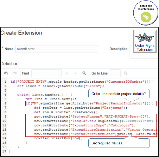

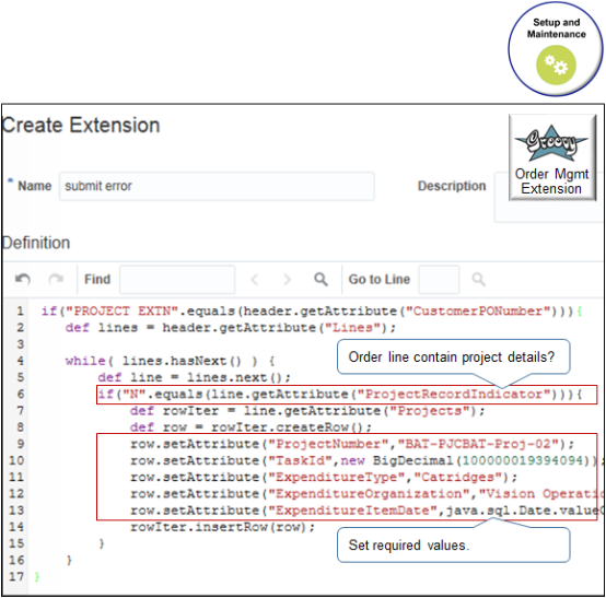

You can include project attributes in an order management extension.
Order Management calls Project Management when the On Start of Submission event happens. The call validates the changes that you make.
For example:
if("PROJECT EXTN".equals(header.getAttribute("CustomerPONumber"))){
def lines = header.getAttribute("Lines"){
while(lines.hasNext()){
def line = lines.next();
if("N".equals(line.getAttribute)("ProjectRecordIndicator"))){
def rowIter = line.getAttribute("Projects");
def row = rowIter.createRow();
row.setAttribute("ProjectNumber","BAT-PJCBAT-Proj-02");
row.setAttribute("TaskId",new BigDecimal"1000000019394094");
row.setAttribute("ExpenditureType","Cartridges");
row.setAttribute("ExpenditureOrganization","Vision Operations");
row.setAttribute("ExpenditureItemDate",java.sql.Date.valueOf("2018-07-30"));
rowIter.insertRow(row);
Note
Examine the ProjectRecordIndicator attribute to determine whether the order line contains project details.
Set a value for each of the required project attributes:
ProjectNumber
TaskId
ExpenditureType
ExpenditureItemDate
Use the On Save, On Start of Submission, or On End of Submission event to read project attributes on the order line and ProjectRecordIndicator.
Use the On Save event or the On Start of Submission event to update project attributes on the order line.
Use an extension to set the project attribute's default value when the value is empty.
Don't use:
On End of Submission to update project attributes.
Any extension event to update ProjectRecordIndicator.
An extension to override an existing value of a project attribute.

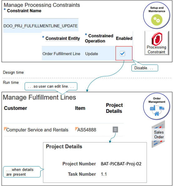

The DOO_PRJ_FULFILLMENTLINE_UPDATE processing constraint comes predefined to prevent you from updating a fulfillment line that includes project details. If you disable it, then you can update attributes that don't contain project details on the fulfillment line, such as the quantity, warehouse, and so on.
You can't update attributes that contain project details on the line after you submit the sales order even if you disable the constraint, such as project number, contract number, expenditure organization, and so on.
Order Management applies the disable behavior only on sales orders that you submit after you disable the constraint. For details, see Processing Constraints.
