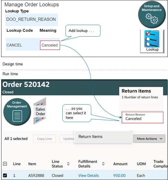

Create Return Reasons
Create a return reason so the Order Entry Specialist can select it when returning an order line.
Assume you need to add a reason you can select to indicate that the customer feels the description you have for the item on your website isn't accurate.

Create Lookup
In the Setup and Maintenance work area, go to the task.
Offering: Order Management
Functional Area: Orders
Task: Manage Order Lookups
On the Manage Order Lookups page, enter the value, then click Search.
Attribute
Value
Lookup Type
DOO_RETURN_REASON
In the Lookup Codes area, click Actions > New then set the values.

Go to the Order Management work area and search for a sales order.
Attribute
Value
Status
Closed
You can only return a sales order that isn't open and that's closed, or an order line that Order Management has shipped but not closed.
Open the sales order, select the order line you want to return, then click Enable Returns.
Verify that you can set the value.
Attribute
Value
Return Reason
Item's Description Isn't Accurate
