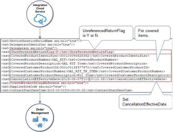

Integrate With Your Source System
Use a web service or import template to integrate your source system so it supports return orders.
Include attributes in your web service payload.
Attribute |
Description |
UnreferencedReturnFlag |
Specify whether the payload references the original return.
Covered attributes, such as CoveredProductIdentifier |
Specify covered item details. |
CancellationEffectiveDate |
Date that reverse billing goes into effect. |
