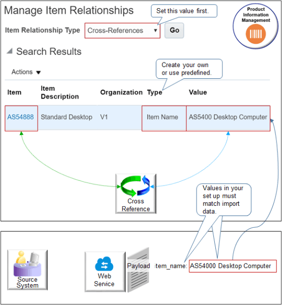

Use Product Information Management to create a cross-reference for Order Management.
In this example, assume your source system uses AS54000 Desktop Computer for the item name, but you use AS54888 Desktop Computer in Product Information Management and in your fulfillment system. You will create a cross-reference that establishes a relationship between these names.

Go to the Product Information Management work area, then click Tasks > Manage Item Relationships.
On the Manage Item Relationships page, set Item Relationship Type to Cross-References, then click Go.
In the search results, click Actions > Create
In the Create Cross-Reference Relationship dialog, set the values.
Attribute
Value
Organization
Vision Operations
Item
AS54888
Type
Item Name
This is the value you created earlier in this procedure on step 2.
Value
Description
Cross-reference to the AS54000 on our legacy source system.
Click Save and Close.
Product Information Management creates a cross-reference between item AS54888 in Product Information Management and item AS54000 Desktop Computer in your legacy order capture system.
