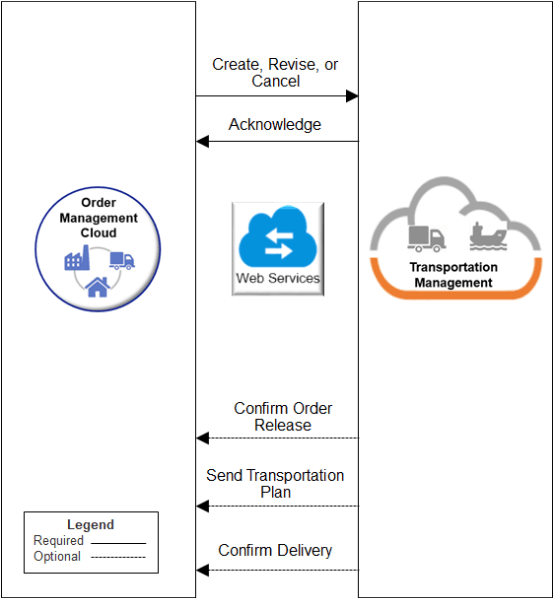

Use Web Services

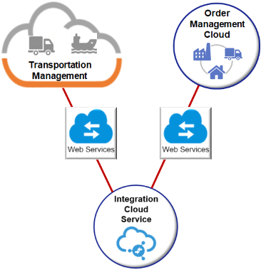

Order Management doesn't come predefined to integrate with Transportation Management or Global Trade Management. You can use Oracle Integration Cloud, a synchronous web service, or an asynchronous web service to integrate with your transportation management system.
| Required | Optional |
Send fulfillment details from Transportation Management to Order Management. For example, confirm that Transportation Management created the order release, send transportation plan that includes updated schedule dates, or send delivery confirmation details, such as delivery date. |

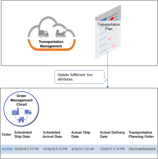

Get Transportation Plan
As an option, get details about the transportation plan from Transportation Management to update attributes in Order Management.
Note
Get updated scheduled dates and order release number from Transportation Management.
Prevent Order Management from updating the sales order after it sends it to Transportation Management. See the section about constraints later in this topic.
Note these points about getting the transportation plan and delivery confirmation.
The transportation plan uses the DOO_TP_PLANNED value in the TaskInstanceStatusCode attribute.
The transportation plan updates the Scheduled Ship Date attribute and the Scheduled Arrival Date attribute.
If Transportation Management splits the transportation plan into two separate shipments, then Transportation Management sends the latest date of these shipments to Order Management. For example, if shipment one delivers on January 1, and shipment two delivers on January 15, then the transportation plan that Transportation Management sends to Order Management will include only the latest date of the finished shipment, which is January 15.
If the orchestration process receives the transportation plan when its not on a wait step, then it will reject the plan and will reject the request to update.
To make sure the orchestration process reaches a wait step, allow about 10 minutes between the most recent update that Order Management sends to Transportation Management, and the time when Transportation Management sends the plan update to Order Management.

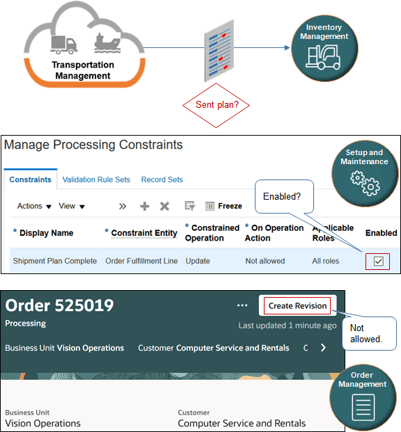

Prevent Changes After Transportation Planning Finishes
If you use Oracle Inventory Management before Update 18C, then enable the predefined Shipment Plan Complete processing constraint.
Note
Shipment Plan Complete prevents you from revising the order line in the Order Management work area after Transportation Management sends the transportation plan to Inventory Management. This constraint comes predefined as disabled. You can enable it during set up.
Before Update 18C, Inventory Management supports only a quantity change or order cancel after Transportation Management sends the transportation plan to Inventory Management. Inventory Management doesn't support any other order revisions before Update 18C.
Inventory Management supports revisions starting with Update 18C. You can disable Shipment Plan Complete after you move to Update 18C. For background, see Performing Your Quarterly Update (Doc ID 2337485.1).
Order Management uses the transportation plan to determine whether Transportation Management already sent the transportation plan to Shipping.
If you don't use Oracle Inventory Management, then don't enable the Shipment Plan Complete constraint.
For details, see Manage Processing Constraints.

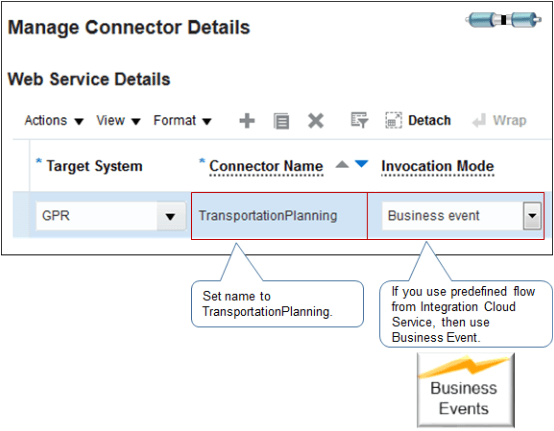

Set Up Connector
Set up a connector on the Manage Connector Details page.
Note
Attribute |
Description |
Connector Name |
Name the connector TransportationPlanning. Order Management uses this name at various locations in the flow. Using TransportationPlanning will help you identify the connector involved in the flow that you're setting up or during troubleshooting. |
Invocation Mode |
If you.
User Name |
Make sure you have the DOO_MANAGE_WEB_SERVICE_INTERFACE_TO_TRANSPORTATION_DATA_FOR_SALES_ORDER_PRIV privilege. For details about how to set up privileges, see Security Reference for Order Management. |

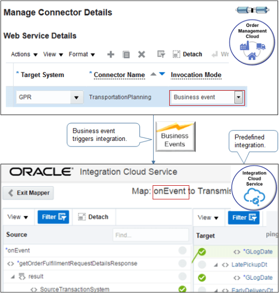

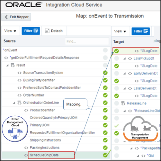

Use Predefined Integration in Integration Cloud Service
Use a predefined integration in Integration Cloud Service as a starting point for your integration. Use the TransportationPlanning connector to connect through a business event.
For example:
Note
A business event triggers the integration.
One order line in Order Management maps to one order release plus one order release line in Transportation Management. For example, the integration maps the ScheduleShipDate attribute in Order Management to the GLogDate attribute in Transportation Management.
Modify the predefined integration to meet your business requirements. For example, to group order lines in a shipment set or configured item, group them into a single order release in Transportation Management.
Transportation Management sends a status update to Order Management for each order release line that maps to one order line.
Examine predefined integrations that use Integration Cloud Service.
Go to Oracle Logistics Cloud to Oracle Fusion Cloud SCM Integration and read the content.
Click Get App to access Integration with OTM or GTM using ICS (Doc ID 2209248.1).
Import one of the example integrations into Integration Cloud Service. For example, import integration OTM_OM, Communicate Order Shipping Information to Order Management.
Examine the integration in the Integration Cloud Service user interface.
