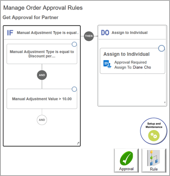

For example, in the If area:
Click New Condition (the dashed circle).
In the Create Condition dialog, enter
adj
, wait a moment, then click Manual Adjustment Type. -
Set the condition to
Manual Adjustment Type is equal to Discount Percent
, then click OK. -
Click And.
adj
, wait a moment, then click Manual Adjustment Value. -
Manual Adjustment Value > 10
, then click OK.

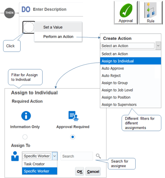

Specify the Action
What should we do if the condition evaluates to true? You have a range of choices, such as Assign to Individual, Assign to Group, Assign to Supervisors, and so on. The rule editor filters your choices depending on the action that you select.
For example, if you select:
Assign to Individual. A dialog displays where you can select the individual. It includes other options, such as Information Only or Approval Required.
Assign to Group. A different dialog displays where you can select the group.

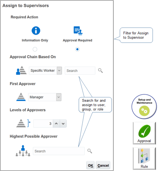

Assign to Supervisors. A different dialog displays where you can specify the approval chain, first approver, level of supervisors, highest approver, and so on.
Click Then > Do.
Click New Action > Perform an Action.
In the Create Action dialog, click Assign to Supervisors.
Set the value in Approval Chain Based On first. It affects values you can chose in other attributes, such as First Approver.
Here's the rule for this example.
The rule is:
If Manual Adjustment Type is
Discount Percent, and if Manual Adjustment Value is greater than 10,
then assign approval to Diane Cho.

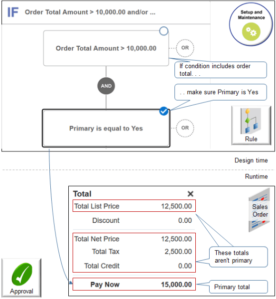

Use the Primary Total
If your condition references the order total, then make sure your rule specifies the primary total.
A sales order includes more than one total. For example, it includes the header total, total list price, total net price, total tax, total credit, and so on. The header total is the primary total. In the price breakdown dialog, it displays on the Pay Now row.
Assume you create an approval rule that filters only
according to Order Total Amount is greater than
10,000
. At runtime, the rule will create a separate approval
request for each order total that's greater than 10,000 although you
require only one approval request for the sales order.
To avoid this problem, add another condition that
filters approval according to Primary equals
Yes
. This way, the rule evaluates only the primary order
total, ignores the other totals, and sends only one approval request.
