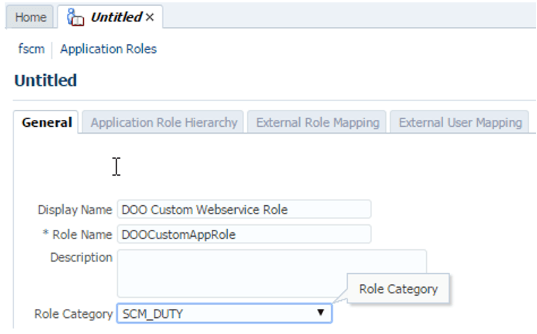

Sign into the security console.
Click Application Roles.
On the General tab, set the values, then save your changes.
Attribute
Value
Display Name
DOO Modified Role Service
Role Name
DOOModifiedAppRole
Role Category
SCM Abstract Roles

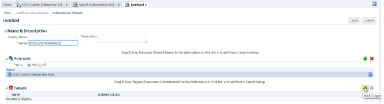

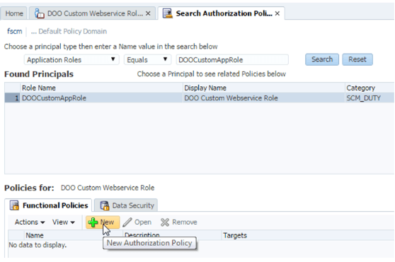

Navigate to the Search Authorization Policies tab, then search for DOOCustomAppRole.
In the Functional Policies tab, click New.
In the Untitled tab, set the value, then save your changes.
Attribute
Value
Name
DOOCustomRolePolicy

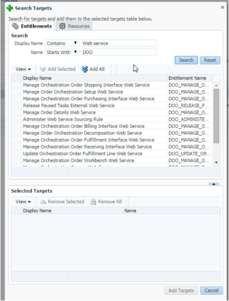

In the Targets area, click Add Target.
In the Search Targets dialog, set values, then click Search.
Attribute
Value
Display Name Contains
Web service
Name Starts With
DOO

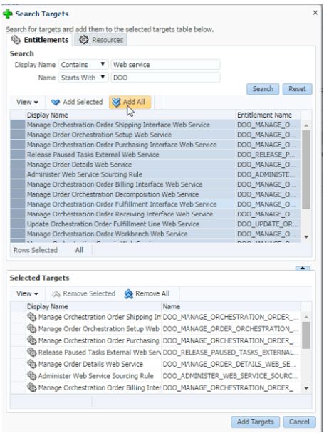

Add the privileges you need for each of the web services that you must grant to the user.

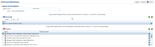

Navigate to the DOOCustomRolePolicy page.

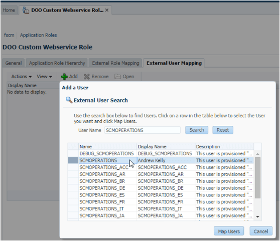

In the
DOO Webservice Role
area, click Add. -
In the Add a User dialog, add a user, then click Map Users.
