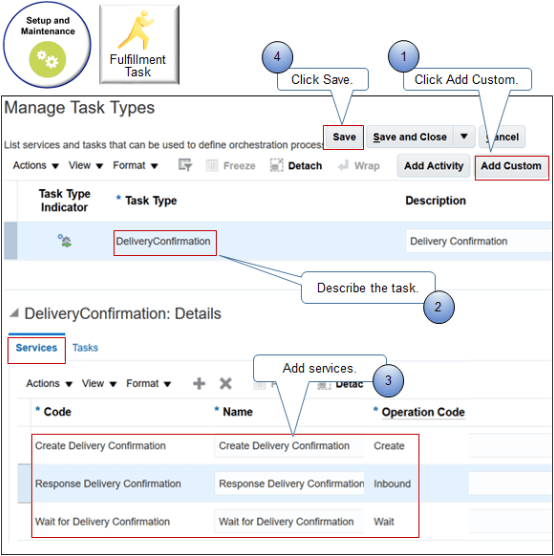

2: Set Up Task Type
Use the Manage Task Type task in the Setup and Maintenance work area to set up the task type:
Note
Click Add Custom. Use this action you to specify services.
Use the Task Type attribute and the Description attribute to describe how your orchestration process uses the task, such as Delivery Confirmation.
Use the Services tab to add the service that does the task, such as Create Delivery Confirmation.
Click Save so you can reference the task type from your orchestration process.
The task type specifies the type of task that each orchestration process step does, such as to schedule an order line for shipment, to ship it, or to confirm delivery. For details, see Create Your Own Task Type.

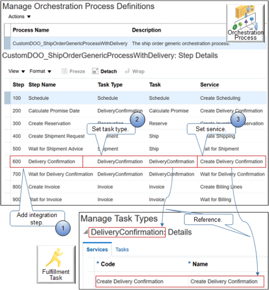

3: Add Integration Step
Add the step in your orchestration process that integrates with your fulfillment system:
Note
Add the step at the point in your orchestration process where you must integrate. This example integrates after the orchestration process finishes the schedule, promise, reserve, and ship tasks, but before the invoice task.
On the integration step, set the Task Type attribute and the Task attribute to the task type you set up on the Manage Task Types page.
Set the Service attribute to the service you set up on the Services tab of the Manage Task Types page.
For details, see Set Up Orchestration Processes.

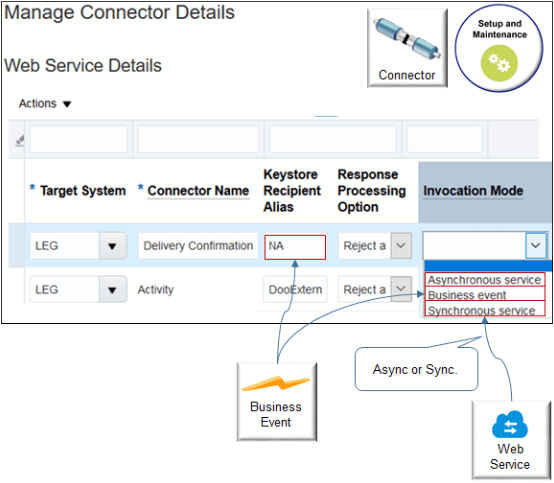

Set other attributes on the connector:
For example:
If you use this connector to communicate a business event, then set the Keystore Recipient Alias attribute to NA, and set the Invocation Mode attribute to Business Event.
If you use this connector with a web service, then set Invocation Mode to Asynchronous Service or Synchronous Service.

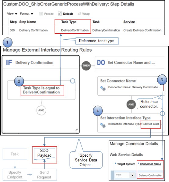

5: Create Routing Rule
Create the rule that routes the orchestration process to the connector that you just created:
Note
Use Visual Information Builder to create the rule. See Overview of Using Business Rules With Order Management.
Add an If statement to determine whether the task type matches the type you specified in the Task Type attribute on the orchestration process step.
If Task Type is equal to DeliveryConfirmation
Add a Then statement to set the Connector Name attribute to the connector you created earlier that connects to your fulfillment system.
Set Connector Name: Delivery Confirmation
Add a Then statement to set the Interaction Interface Type attribute. Recall from the flow that order orchestration uses an SDO payload to communicate with your fulfillment system. You must use Service Data Object for any new implementation. Use other values only for backward compatibility to an earlier Oracle Applications update.
Set Interaction Interface Type: Service Data Object

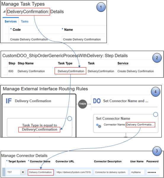

Summary
Here's a summary of the set up:
Use these pages:
Manage Task Types to create the task type.
Manage Orchestration Process Definitions to add the integration step.
Manage Connector Details to create the connector.
Manage External Interface Routing rules to route the order line to your fulfillment system.
