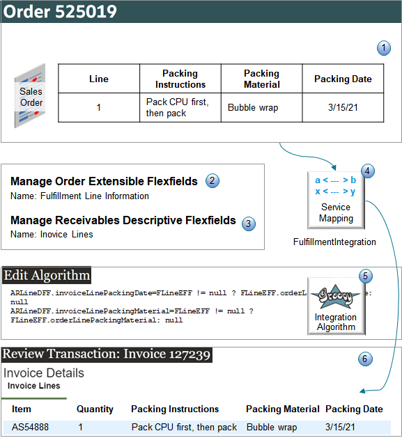

Integrate Your Own Order Line Attributes Between Order Management and Oracle Receivables
Use an extensible flexfield in Order Management to capture your own order line details, then send them to a descriptive flexfield so you can see these details on invoices in Oracle Receivables.
Note
Assume you need to add your own shipping details when you create an order line for a new sales order in Order Management:
Packing instructions
Packing material
Packing date
You will add these attributes to the Fulfillment Line Information extensible flexfield.
You edit the Invoice Lines descriptive flexfield so you can display shipping details on the invoice line.
You modify the FulfillmentIntegration service mapping to map the extensible flexfield between Order Management and the descriptive flexfield in Oracle Receivables.
You create an integration algorithm that specifies the data to communicate.
You use the Billing work area to examine the invoice that contains the shipping details.
Summary of the Setup
Prepare your setup.
Edit extensible flexfield.
Edit service mapping for extensible flexfield.
Edit descriptive flexfield.
Edit service mapping for descriptive flexfield.
Create integration algorithm.
Test your set up.

Edit Descriptive Flexfield
Create the descriptive flexfields that Oracle Receivables will use to store the data that it receives from Order Management.
In the Setup and Maintenance work area, go to the task.
Offering: Financials
Functional Area: Receivables
Task: Manage Receivables Descriptive Flexfields
On the Manage Receivables Descriptive Flexfields page, search for the value.
Attribute
Value
Name
Invoice Lines

Edit Service Mapping for Descriptive Flexfield
Edit the service mapping so Oracle Receivables can receive the attribute details that Order Management sends.
Go to the Pricing Administration work area.
Use order administrator privileges so you can access the integration algorithm and service mappings that you use in the Pricing Administration work area to set up the integration.
Click Tasks, then, under Order Management Configuration, click Manage Service Mappings.
Enter your sand box.
On the Manage Service Mappings page, in the Name column, click FulfillmentIntegration.
Modify the entity.
On the Edit Service Mappings page, on the Entities tab, click the row that contains the value.
Attribute
Value
Entity
TransactionLineDff

Create Integration Algorithm
To implement the logic you need, you will modify the integration algorithm from another help topic.
Click Tasks, and then, under Order Management Configuration, click Manage Algorithms.
On the Manage Algorithms page, click Actions > Create.
On the Create Algorithm page, set values.
Attribute
Value
Name
Integrate_OM_and_AR Custom
You can use any text, except you must suffix the name with a space, then the word Custom.
Click Save.
Click Variables, click Actions > Add Row, set the values, then click Save.
Attribute
Value
Name
ARIntegration
Data Type
Data Object
Required
Contains a check mark.
Input/Output
Input and Output
Internal Service Schema
FulfillmentIntegration.InvoiceService
Click Algorithm.
Click Add Step > Conditional Action.
In the Data Sets area, click Add Row, then set the values.
Attribute
Value
Name
FLine
Variable Path
ARIntegration.FulfillLine
Primary
In the Execute Condition area, click Add Condition > Default Action.
In the Actions window, add the code, then click Save.
ARLineDFF.invoiceLinePackingDate=FLineEFF != null ? FLineEFF.orderLinePackingDate: null ARLineDFF.invoiceLinePackingMaterial=FLineEFF != null ? FLineEFF.orderLinePackingMaterial: nullHere's what the code does.
Code
Description
ARLineDFF.invoiceLinePackingDate=FLineEFF != null ? FLineEFF.orderLinePackingDate: nullIf the value of the orderLinePackingDate attribute on the extensible flexfield.
Contains a value. Set the value of the invoiceLinePackingDate attribute on the descriptive flexfield to the value that orderLinePackingDate contains.
Doesn't contain a value. Set the value of invoiceLinePackingDate to empty.
ARLineDFF.invoiceLinePackingMaterial=FLineEFF != null ? FLineEFF.orderLinePackingMaterial: nullIf the value of the orderLinePackingMaterial attribute on the extensible flexfield.
Contains a value. Set the value of the invoiceLinePackingMaterial attribute on the descriptive flexfield to the value that orderLinePackingMaterial contains.
Doesn't contain a value. Set the value of invoiceLinePackingMaterial to empty.
Test your algorithm, then click Save and Close.

Test Your Setup
Create a sales order.
Go to the Order Management work area and create a sales order.
Attribute
Value
Customer
Computer Service and Rentals
Add an order line and set the values on the line.
Attribute
Value
Item
AS54888
Quantity
1
Click Additional Order Details, then scroll to Additional Order Information.
Click Ship Instructions, then verify that the Ship Instructions contains your Packing Material and Packing Date flexfield attributes.
Add some test values in your flexfield attributes, then click Done.
Attribute
Value
Packing Instructions
Test value for packing instructions.
Packing Material
Test value for packing material.
Packing Date
Test value for packing date.
Click Submit.
Assume your order number is 55748.
Verify that Order Management correctly sends your data to Oracle Receivables.
Make sure you have the privileges that you need to manage Oracle Receivables. For details, see Get the Privileges That You Need to Implement Order Management.
Go to the Billing work area, then click Tasks > Manage Transactions.
For details, go to Using Receivables Credit to Cash, then search for Requirements for Completing a Receivables Transaction.
On the Manage Transactions page, search for the transaction.
Attribute
Value
Business Unit
Vision Operations
Transaction Source
Distributed Order Orchestration
Reference
55748
On the Review Transaction page, in the Invoice Details area, verify that the invoice contains attributes and attribute values for packing instructions, packing material, and packing date.
