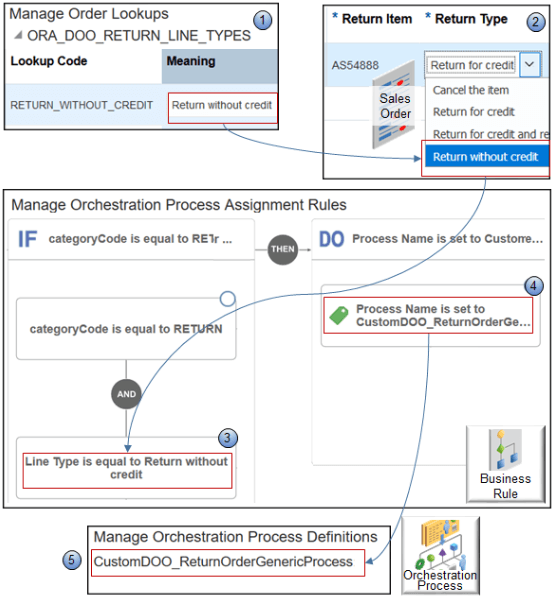

Set up Order Management so your users can return a sales order without creating a credit memo.
You might not want Order Management to create a credit memo, such as if you allow customers to return a competitor's order. You will set up this flow:
the flow you will set up.
Note
  1. You create a lookup that allows your user to specify whether it's a return without credit.
  2. You search for and view a closed sales order, click Enable Returns, then set the Return Type attribute.
  3. You create an assignment rule.
    • If CategoryCode is equal to Return, and
    • If Line Type is equal to Return Without Credit
  4. You create an action in your rule.
    • Assign the CustomDOO_ReturnOrderGenericProcess orchestration process.
  5. You create CustomDOO_ReturnOrderGenericProcess. You copy the predefined ReturnOrderGenericProcess, then remove steps so it doesn't issue a credit memo.

Create the Assignment Rule
Create and publish an assignment rule that assigns your orchestration process.
  • Create the If statement.
  • If categoryCode is equal to Return, and Line Type is equal to Return without credit
  • Create the Then statement.
    Process Name is set to CustomDOO_ReturnOrderGenericProcess
  • Publish and test your rule.
Learn how to create an assignment rule. For details, see Overview of Using Business Rules With Order Management.
