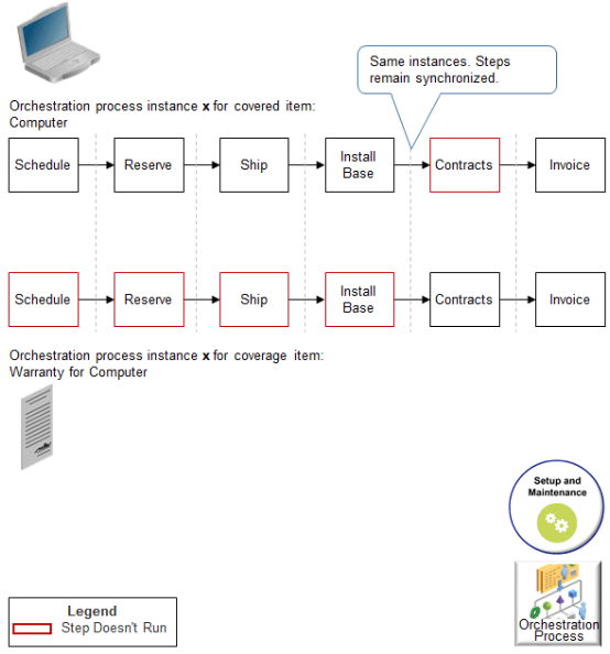

Set up your orchestration process. Here's an example.
Note
A red step means the step doesn't apply to the item so the orchestration process skips the step. For example, you don't schedule, reserve, or ship a warranty, so those steps don't run for the warranty.
The covered item and the coverage item move together through the same steps, at the same time.
If a step applies to the covered item but not the coverage item, then the coverage item will be in a Not Started status, and remain in this status until it reaches a step that applies to the covered item and the coverage item.
In this example, the Warranty for Computer coverage item is in the Not Started status all the way to the Invoice step because the Invoice step is the first step in the process that applies to the covered item and the coverage item.

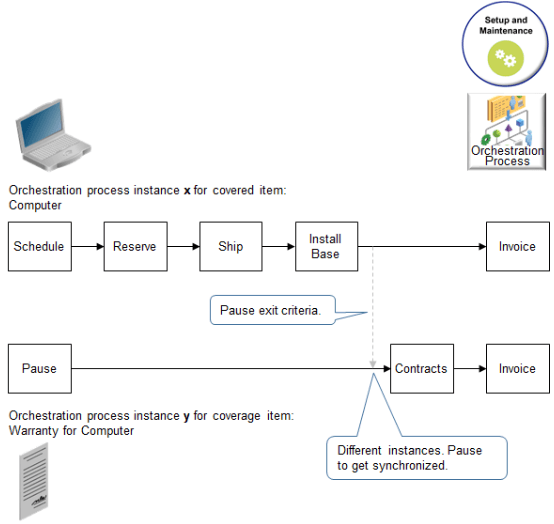

Here's an example that illustrates how you can use a pause task to make sure the coverage item and covered item go to billing at the same time.
Note
Orchestration process instance x can process the covered item independently of the coverage item.
Orchestration process instance y can process the coverage item independently of the covered item.
The coverage item will proceed directly to the pause task, then wait until the covered item finishes the Install Base step.
The Install Base step finishes, the orchestration process releases the pause on the coverage item, and then the covered item and coverage item move together to the Invoice task.
Add a pause task.
If your orchestration process includes an invoice step, then make sure you do the billing step for the covered item and the coverage item at the same time.
Fulfillment for the covered item is almost always behind fulfillment for the coverage item because the covered item goes through shipping but the coverage item doesn't. So, to do billing at the same time, add a pause step immediately before the invoice step in the orchestration process that processes the coverage item. This way, fulfillment for the coverage item pauses while it waits for fulfillment for the covered item to get to the billing step.
The pause task makes sure the orchestration process instance that processes the coverage item doesn't get too far out in front of the instance that processes the covered item. For example, the Contracts step must not process the coverage item until after the covered item ships and the Install Base step runs.

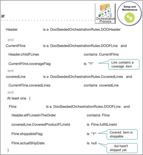

Here's an example If statement for the pause task.
Pseudocode for the If statement.
If the order line contains a coverage item, and if the order line that the coverage item covers is shippable but hasn't yet shipped

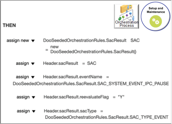

Here's an example Then statement for the pause task.
The pause continues until actualShipDate contains a date, which indicates that shipping has shipped the covered item and the orchestration process can proceed to the billing step.
