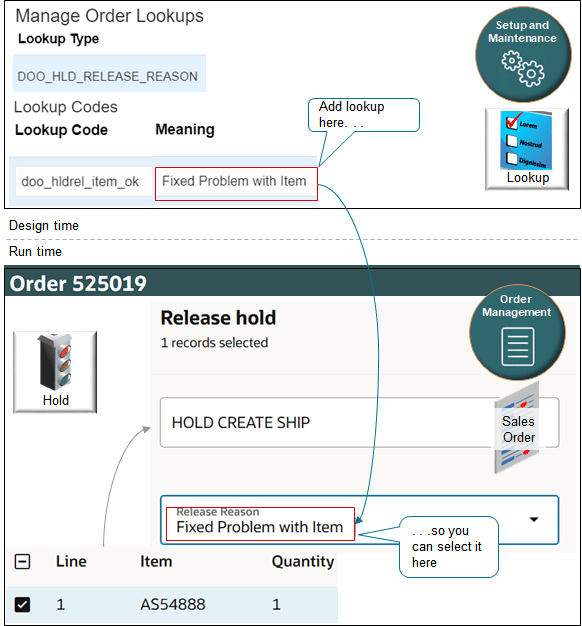

Create a Release Reason
Create a reason that your user can choose to indicate why they released the hold.
Try it.
  1. In the Setup and Maintenance work area, go to the task.
    • Offering: Order Management
    • Functional Area: Orders
    • Task: Manage Order Lookups
  2. On the Manage Order Lookups page, enter the value, then click Search.
    Attribute
    Value
    Lookup Type
    DOO_HLD_RELEASE_REASON
  3. In the DOO_HLD_RELEASE_REASON: Lookup Codes area, click Actions > New then set the values.
    Attribute
    Value
    Lookup Code
    doo_hldrel_item_ok
    Display Sequence
    1
    Start Date
    The current date.
    End Date
    One week from today.
    Meaning
    Fixed Problem with Item
    Description
    Fixed the problem with the item.
  4. Click Save and Close.
