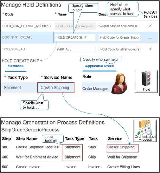

Create Your Hold Code
Note
Use the Setup and Maintenance work area to manage hold codes, orchestration processes, and task types.
Use the hold code to specify the task to hold, such as creating the invoice.
Specify the service, or specify the task type.
Set the attributes:

Use the Applicable Roles tab to specify who can apply and release the hold, such as the Order Manager.

Consider the Hold All Services Option
If You Don't Enable the Hold All Services Option |
If You Enable the Hold All Services Option |
The service that you specify affects each orchestration process step that references the service. Assume you:
Your hold affects only step 300 of the ShipOrderGenericProcess orchestration process because step 300 is the only step that references the Create Shipping service. Use this option when you want some of the services of the task type to run but not others. For example, you want to put a hold on Create Shipping until you verify the orchestration process successfully created the shipment request, but you want the process to automatically do the Wait for Shipment task after you remove the hold for Create Shipping. |
The task type that you specify affects each orchestration process step that references the task type. Assume you:
Your hold affects step 300 and step 400 because these steps reference the Shipment task type. Use this option when you don't any part of the task to run. Let's say you're shipping a highly flammable, dangerous item. Before shipping, you place a hold to verify the carrier is licensed to handle hazardous material. Enable the Hold All Services option on the shipping task type to make sure no part of shipping runs. |
