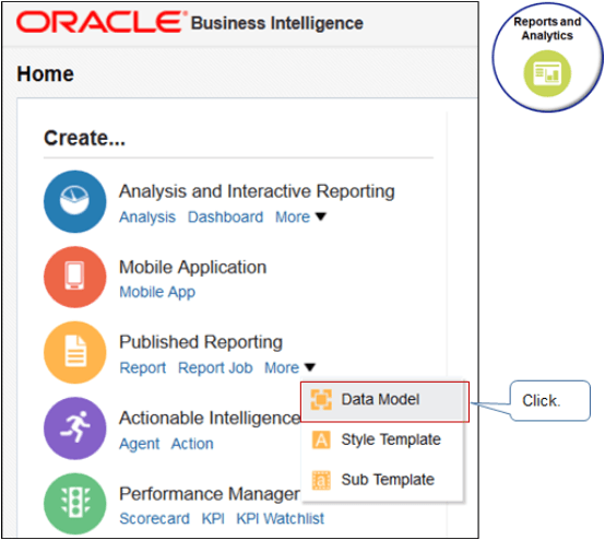

Create the data model.
In the Create area, under Published Reporting, click More > Data Model.
You use a data model to set up the SQL you use to query the Oracle database. You can reuse the data model for different SQL queries. It isn't necessary to create and save a separate data model for each SQL query.

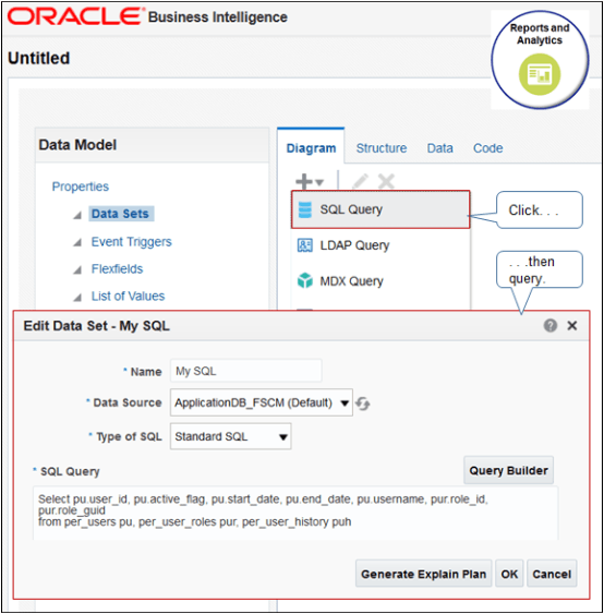

On the Diagram tab, click New Data Set > SQL Query.
In the New Data Set SQL Query dialog, set the values.
Attribute
Value
Name
My SQL
Data Source
ApplicationDB_FSCM (Default)
FSCM means Fusion Supply Chain Management.
Type of SQL
Standard SQL
SQL Query
Select pu.user_id, pu.active_flag, pu.start_date, pu.end_date, pu.username, pur.role_id, pur.role_guid Select pu.user_id, pu.active_flag, pu.start_date, pu.end_date, pu.username, pur.role_id, pur.role_guid from per_users pu, per_user_roles pur, per_user_history puhYou can enter some other query. For example, to get all order headers, enter this:
SELECT * FROM fusion.DOO_HEADERS_ALLTo get all order lines, enter this:
SELECT * FROM fusion.DOO_LINES_ALLFor example:

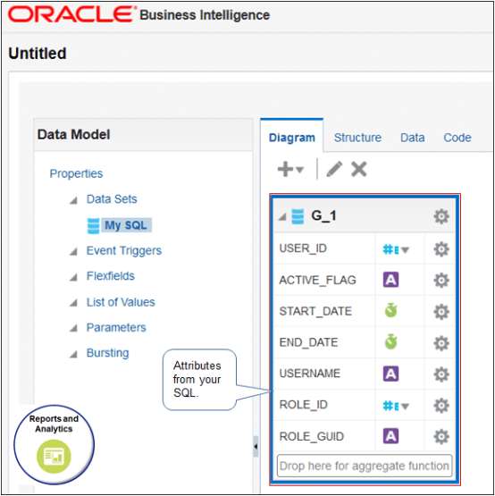

Click OK.
The Diagram tab displays the attributes that your SQL defined.

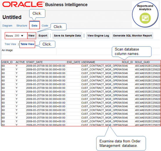

Click View Data, set Rows to 200, click View, click Table View, then examine the output.
In the upper-right corner, click Save, then save the output in My Folders.

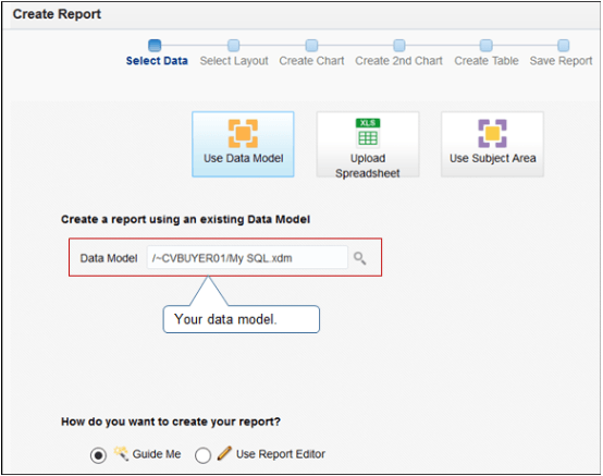

In the upper-right corner, click Create Report.
The Create Report wizard displays for your data model.
Click Next.

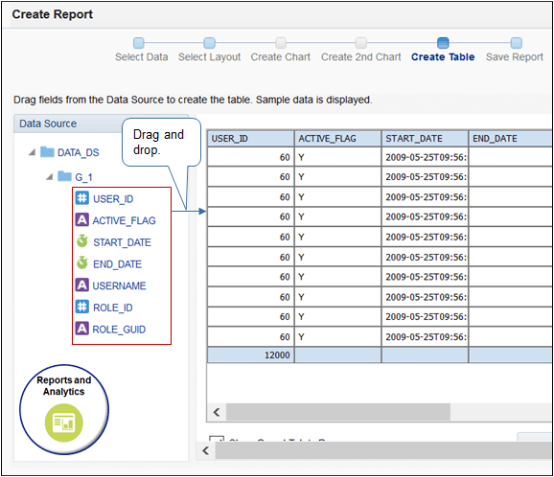

On the Select Layout step, enable the Landscape option, enable the Table option, then click Next.
On the Create Table step, adjust the layout to fit your needs, then click Next.
For example, drag and drop columns from the data source to the table.

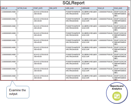

On the Save Report step, enable the View Report option, then click Finish.
Save the report, name it, such as SQLReport, then examine the results on the report output that displays.
As an option, save the result to a file type of your choice.

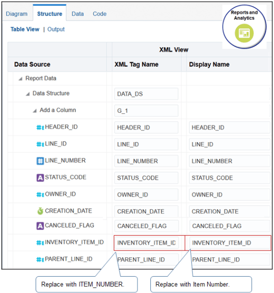

Add a Field
You can't extend the predefined data model for Order Management. Instead, you can replace a field in the report output with the one you need.
Order Management uses the term item to describe the product your customer buys. The AS54888 Computer is an example of an item. The predefined data model uses the INVENTORY_ITEM_ID column to store the value that identifies the item. In this example, you replace INVENTORY_ITEM_ID with ITEM_NUMBER so your report output is more consistent with this usage.
Do steps 1 through 5 from earlier in this topic, except use these values in the New Data Set SQL Query dialog.
Attribute
Value
Name
Add a Column
Data Source
Type of SQL
Standard SQL
SQL Query
SELECT * FROM fusion.DOO_LINES_ALL -
Click Structure > Table View.
Locate the row that contains INVENTORY_ITEM_ID in the XML Tag Name column.
Modify values in the row you located.
Attribute
Old Value
New Value
XML Tag Name
INVENTORY_ITEM_ID
ITEM_NUMBER
Display Name
INVENTORY_ITEM_ID
Item Number
