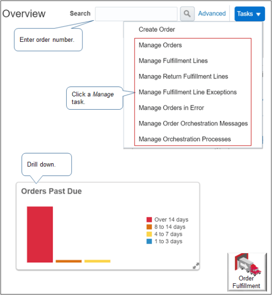

There are many ways to monitor fulfillment.
Note
Enter your order number in the Search field.
Use one of the Manage tasks.
Click a bar on one of the bar charts.
In this example, you will use the Manage Orders task.
Go to the Order Management work area, click Tasks > Manage Orders, then search for your sales order.

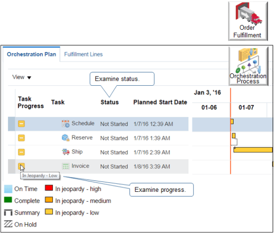

Click an orchestration process number, such as 300100090333478.
On the Orchestration Plan tab, examine the fulfillment tasks that the orchestration process scheduled to fulfill the order line, and the current status of each fulfillment task.
Here's an example where the jeopardy is low for each fulfillment task.
Note
None of the tasks have started.
The orchestration process might not start a fulfillment task for a number of reasons, such as the Planned Start Date hasn't happened, the Earliest Acceptable Ship Date might happen too far in the future, or other sales orders might have higher priority.
For details, see Fix Problems and Improve Performance.
