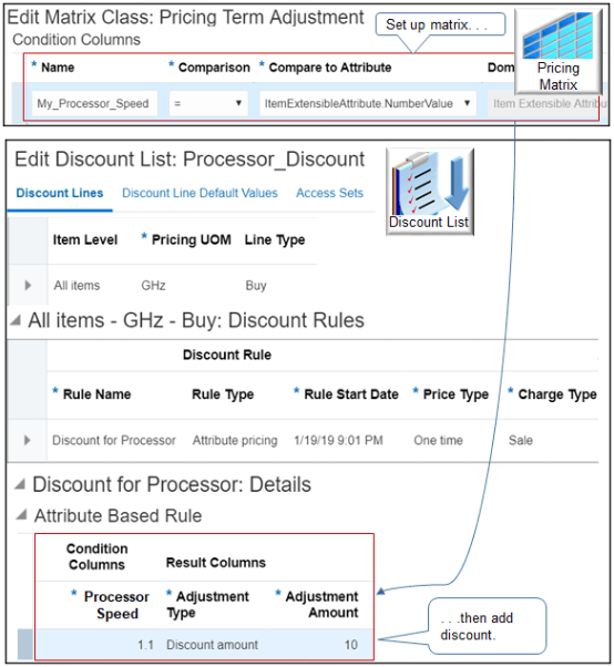

Vision Corporation sells a microprocessor item and provides a discount according to processor speed. You can create an item extensible attribute named Processor Speed, and set up a discount for the microprocessors that run at 1.1 GHz.
      Note

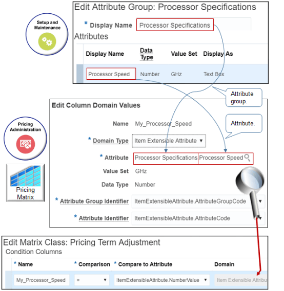

            Use the Setup and Maintenance work area to create an item extensible attribute named Processor Speed, and to add it to the Processor Specifications attribute group.
            Use the Pricing Administration work area to create a pricing term adjustment that references the Processor Speed attribute.
            Use the Domain to reference Processor Speed.
Here's the format that the Domain column uses.
            attribute_group_identifier.attribute_identifier:attribute_group.attribute_name. = default_value
where
            attribute_group_identifierspecifies the attribute of the service data object to use when comparing against the attribute group code.
            attribute_identifierspecifies the attribute of the service data object to use when comparing against the attribute code.
Note
            AttributeGroupCode specifies to use the Processor Specifications attribute group when comparing against the attribute group code.
            AttributeCode specifies to use the Processor Speed attribute when comparing against the attribute code.

               Create the attribute group. -
                     On the Manage Attribute Groups page, click Actions > Create. For details, see Item Attribute Groups and Attributes.
                     On the Create Attribute Group page, create an attribute group. Attribute Value Display Name Processor Specifications Internal Name Processor Specifications API Name ProcessorSpecifications Behavior Single Row Enabled Contains a check mark Flexfield Code EGO_ITEM_EFF
                     On the Context Usages tab, click Actions > Create, then set the value. Other values are optional. Attribute Value Name Item
                     Click Save
               Create the attribute. -
                     In the Attributes area, click Actions > Create.
                     On the Create Attribute page, set the values. Attribute Value Name Processor Speed Internal Name Processor Speed API Name ProcessorSpeed Flexfield Code EGO_ITEM_EFF Data Type Number
                     Click Create Value Set.
                     On the Create Value Set page, set the values. Attribute Value Value Set Code GHz Description Gigahertz Module Product Model Validation Type Independent You must select Independent or Format Only for each item extensible attribute that you plan to use with Pricing. Value Data Type Number
                     Click Save and Close.
                     In the Display Properties area, set the value, then click Save and Close. Attribute Value Display Type Text Box You must select Text Box or List of Values for each item extensible attribute that you plan to use with Pricing.
               On the Edit Attribute Groups page, click Save and Close.

Edit the Matrix Class
Edit the matrix class so you can reference it from a rule in a discount list. For details, see Pricing Matrix Class.
               Go to the Pricing Administration work area, then click Tasks > Manage Matrix Classes.
               On the Manage Matrix Classes page, click Pricing Term Adjustment.
               On the Edit Matrix Class page, in the Condition Columns area, click Actions > Add Row, then set the values. Attribute Value Name My_Processor_Speed Source Code Name Accept the default value. Comparison = (equals sign) Compare to Attribute Select an attribute. For this example, processor speed is a Number data type, so select itemExtensibleAttribute.NumberValue.Make sure you select the same data type that you specify when you set up the attribute on the Manage Item Attribute Groups and Attributes page. If these data types don't match, then Pricing can't calculate the price. You can select only one of these values. -

               Set the domain. -
                     In the Domain column, click Edit Domain.
                     In the Edit Column Domain Values dialog, set the value. Attribute Value Domain Type Item Extensible Attribute
                     In the Attribute field, click the magnifying glass.
                     In the Search and Select dialog, set the value, then click Search. Attribute Value Attribute Name Processor Pricing uses the attribute you specify in the input SDO (service data object) of the service mapping. For details, see How Service Mappings, Pricing Algorithms, and Matrixes Work Together. Note -
                           The Search and Select dialog gets the attributes that it displays from the Manage Item Attribute Groups and Attributes page. You can search on any text as long as it matches the attributes that you define on this page. For example, if the Processor Specifications attribute group in the Manage Item Attribute Groups and Attributes page contains the Processor Speed attribute, then you can search Attribute Group for Processor Specifications.
                           Only some of the attributes from the Manage Item Attribute Groups and Attributes page are useful for Pricing. For example, it might contain several thousand attributes for processors for use in different contexts. You can use the attribute group to help filter the search results so they're specific to Pricing.
                     In the search results, select the attribute that your pricing matrix must reference, such as Processor Speed, then click OK.
                     Here's the dot notation that the Attribute field uses to indicate your choice. -
                           Attribute_group_name.attribute_name
 For example: -
                           Processor Specifications.Processor Speed
                     Set the values. Attribute Value Attribute Group Identifier ItemExtensibleAttribute.AttributeGroupCode Attribute Identifier ItemExtensibleAttribute.AttributeCode
                     Set the value, then click OK. Attribute Value Default Value 1.1 As an option, if you set Default Value, then Pricing will display it on the Discount List page that you administer later in this topic. Pricing gets the attribute values from that item extensible attribute that you set up. In this example, Processor Speed is a Number data type, so you can enter a numeric value. You might define another attribute differently. For example, you might define Color as a Varchar value, and with a set of values, such as blue, green, and red. So, you would select from a list instead of entering a number.
                     Set the value, then click OK. Attribute Value Default Is Fixed Value Doesn't contain a check mark. If you enable Default Is Fixed Value, then you can't modify the default value on the Discount List page.
               On the Edit Matrix Class page, in the Condition Columns area, set the values, then click OK. Attribute Value Allow Null Doesn't contain a check mark. You usually don't enable Allow Null. If you enable it, then the condition column can remain empty when you create the matrix rule. Pricing will evaluate the rule even if the attribute doesn't contain a value. Null is Wildcard Doesn't contain a check mark. You usually don't enable Null is Wildcard. If you enable it, then Pricing will accept an empty value when it processes the matrix rule.
Create the Discount List
         Set up a discount list so it provides a $10 discount for all 1.1 Ghz processors, to apply only on the sales charge.
               On the Overview page, click Tasks > Manage Discount Lists.
               Click Actions > Create.
               In the Create Discount List dialog, set the values, then click Save and Edit. Attribute Value Name Processor_Discount Currency USD Business Unit Vision Operations
               In the search results, click Actions > Add Row, then set the values. Attribute Value Item Level All Items Pricing UOM GHz Line Type Buy
               Expand Discount Rules, then click Actions > Create > Attribute Based Rule.
               In the Create Attribute Based Rule dialog, add a check mark to Processor Speed, then click OK.
               In the Create Discount Rule dialog, set the values, then click OK. Attribute Value Price Type One Time Charge Type Sale Charge Subtype Price Name Discount for Processor
               In the Attribute Based rule area, notice that the dialog displays the Condition Column you set up earlier in this topic, then set the values. Attribute Value Processor Speed 1.1 Notice that the attribute defaults to a value of 1.1, which is the value you set up earlier in this topic. Adjustment Type Discount Amount Adjustment Amount 10
               Click OK.
