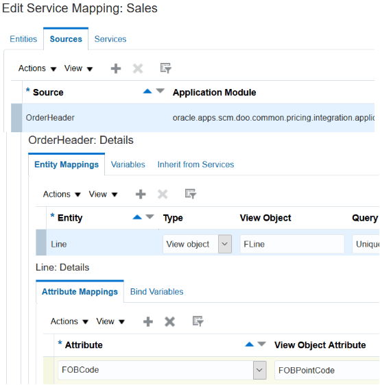

               On the Manage Service Mappings page, click the row that includes the value. Attribute Value Name Sales
               Map the attribute to the order header. -
                     On the Edit Service Mapping page, click Sources, then click the row that includes the value. Attribute Value Source OrderHeader
                     In the OrderHeader Details area, on the Entity Mappings tab, click the row that includes the value. Attribute Value Entity Line
                     In the Line Details area, on the Attribute Mappings tab, click Actions > Add Row, then set the values. Attribute Value Attribute FOBCode View Object Attribute FOBPointCode For example:
