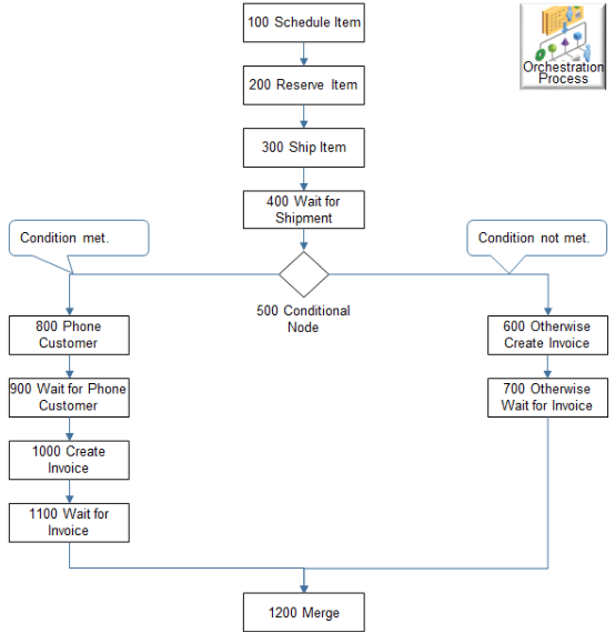

Here's the flow that you will create for this example:
orchestration process flow you create for this example.
Note
  • Each step in the flow includes the step number, task name, task type, and service name.
  • The Conditional Node indicates that an orchestration process is about to branch. The first step of the branch contains the condition.
  • If the flow:
    • Meets the condition. The orchestration process runs the steps on the branch that notifies the representative.
    • Doesn't meet the condition. The orchestration process runs the steps on the branch that don't notify the representative.
  • Order Management adds an empty default branch when it runs the orchestration process. If the orchestration process includes only one branch, then it isn't necessary to set an Otherwise condition.

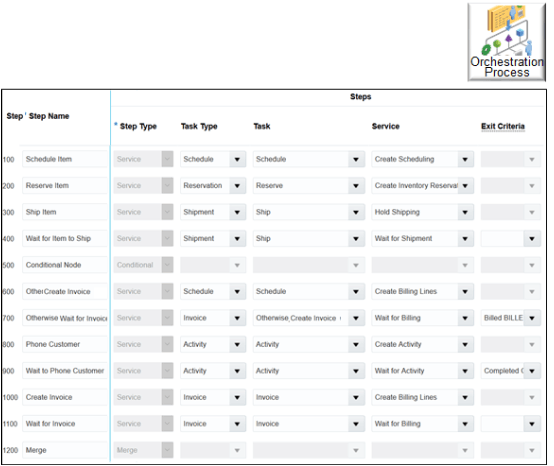

Add the Orchestration Process Steps
You will add these steps:
You will create these steps.
  1. Add a step:
    Attribute
    Value
    Step Name
    Schedule Item
    Step Type
    Service
    Task
    Schedule
    Service
    Create Scheduling
  2. Add another step.
    Tip:
    To maintain the correct sequence when you add each step, click the step you most recently added, then click Add Row.
    Attribute
    Value
    Step Name
    Reserve Item
    Step Type
    Service
    Task
    Reserve
    Service
    Create Inventory Reservation
  3. Add another step:
    Attribute
    Value
    Step Name
    Ship Item
    Step Type
    Service
    Task
    Ship
    Service
    Create Shipping
  4. Add another step:
    Attribute
    Value
    Step Name
    Wait for Item to Ship
    Step Type
    Service
    Task
    Ship
    Service
    Wait for Shipment
    Exit Criteria
    Shipped
    Fulfillment Completion Step
    Contains a check mark.
  5. Add another step:
    Attribute
    Value
    Step Name
    Conditional Node
    Step Type
    Conditional
  6. Add another step:
    Attribute
    Value
    Step Name
    Phone Customer
    Step Type
    Service
    Task
    Activity
    Service
    Create Activity
    Evaluation Sequence
    1
  7. Add another step:
    Attribute
    Value
    Step Name
    Wait for Phone Customer
    Step Type
    Service
    Task
    Activity
    Service
    Wait for Activity
    Exit Criteria
    Completed
  8. Add another step:
    Attribute
    Value
    Step Name
    Create Invoice
    Step Type
    Service
    Task
    Invoice
    Service
    Create Billing Lines
  9. Add another step:
    Attribute
    Value
    Step Name
    Wait for Invoice
    Step Type
    Service
    Task
    Invoice
    Service
    Wait for Billing
    Exit Criteria
    Billed
  10. In the Step Definition list, click the Conditional Node step, then add another step. This step creates the Otherwise branch:
    Attribute
    Value
    Step Name
    Otherwise Create Invoice
    Task Type
    Invoice
    Task
    Each task name that you use with a task type must be unique. You used the Invoice task with the Invoice task type earlier in this procedure, so you must create a new task name.
    To do this, In the Task attribute, click the Search down arrow, then click Create. In the Create Task Name dialog, enter values:
    • Code: 1
    • Name: Otherwise_Create_Invoice
    • Display Name: Otherwise Create Invoice
    • Task Type: Invoice
    Click Save and Close.
    Service
    Evaluation Sequence
    2
    Otherwise
    Planning Default Branch
  11. In the Step Definition list, click the Otherwise Step, Create Invoice step, then add another step. This step creates the Wait for Invoice Step on the Otherwise branch:
    Attribute
    Value
    Step Name
    Otherwise Wait for Invoice
    Step Type
    Service
    Task
    Service
    Wait for Billing
    Exit Criteria
    Billed
  12. In the Step Definition list, click the Wait for Invoice step, then add another step. This step merges the branch back to the main flow:
    Attribute
    Value
    Step Name
    Merge
    Step Type
    Merge

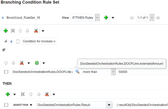

Start by creating the If statement:
  • If the extendedAmount attribute on the order line is more than 50000
Do it.
  1. In the Step Definition list, in the Phone Customer step, in the Branching Condition column, click Click for Rule.
  2. In the Branching Condition Rules dialog, click Add Rule, then click Expand.
  3. Delete the value Rule 1 , and then enter Condition for invoices valued at more than 50000 dollars.
  4. Click Left Value.
  5. In the Condition Browser dialog, expand DooSeededOrchestrationRules > DOOFLine, click extendedAmount, then click OK.
    where
    Code
    Description
    A dictionary that includes predefined rule sets, facts, functions, variables, bucket sets, links, and functions that you can use to orchestrate fulfillment.
    DOO
    Means distributed order orchestration, which is an earlier name for order orchestration.
    FLine
    Order line.
    extendedAmount
    An order line attribute that stores the total value of the sales order.
  6. Click Is, and then click More Than.
  7. Click Right Value.
  8. In the Condition Browser dialog, enter 50000, then click OK. Don't include commas in your value.

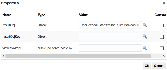

  1. In the Then area, click Add Action > Assert New.
  2. Click Select a Target, then click DooSeededOrchestrationRules.Result.
  3. Click Edit Properties.
  4. In the Properties dialog, in the ResultObj row, click Value.
  5. In the Condition Browser dialog, expand DooSeededOrchestrationRules > Boolean, click True, then click OK.
  6. Make sure the Properties dialog contains these values:
    Name
    Type
    Value
    resultObj
    Object
    DooSeededOrchestrationRules.Boolean.TRUE
    resultObjKey
    Object
    Leave this cell empty.
    viewRowImpl
    oracle.jbo.server.viewRowImpl
    For example:
    values in Properties dialog
  7. Click OK.

  1. Verify that you correctly defined the orchestration process steps and flow:
    • In the header of the Edit Orchestration Process Definition page, click Actions, then click Generate Process Diagram.
    • Make sure the diagram includes the same steps and logic that the diagram at the beginning of this topic displays.
