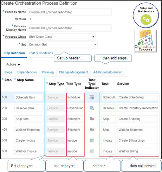

Create the Orchestration Process
  1. Go to the Setup and Maintenance work area, then go to the Manage Orchestration Process Definitions task.
  2. On the Manage Orchestration Process Definitions page, click Actions > Create.
  3. On the Create Orchestration Process Definition page, set the values, then click Save:
    Attribute
    Value
    Process Name
    CustomDOO_ScheduleAndShip
    The set up page automatically adds the CustomDOO_ prefix. You must use this prefix for any orchestration process you create.
    The name must not exceed 80 characters, including the prefix.
    Process Display Name
    Enter any value. Don't include spaces. The value you that enter will display throughout the Setup and Maintenance work area and the Order Management work area.

Add the Orchestration Process Steps
  1. On the Step Definition tab, click Actions > Add Row.
  2. Set the values, then click Save:
    Attribute
    Description
    Step Name
    Enter text that describes the purpose of the step. For this example, enter Schedule Product.
    Step Type
    Select a value that indicates the type of processing that this step does.
    For example, if this step must do conditional branching, then select Conditional. This example calls a service, so select Service.
    Task Type
    Select the group of services that Order Management uses to do a fulfillment task. For this example, select Schedule.
    Task
    Select the task that this step must perform. For this example, select Schedule.
    Service
    Identify the service that this step must call. For this example, select Create Scheduling.
