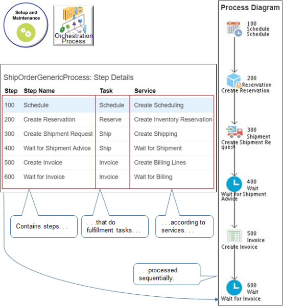

An orchestration process is a sequence of steps that automate fulfilling your sales order's order lines across fulfillment systems. For example, here's the predefined ShipOrderGenericProcess orchestration process:

  • Each process contains steps.
  • Each step calls a service that does a fulfillment task. The service communicates with the fulfillment system to do the task. For example:
    Step
    Service
    Description
    Step 100, Schedule
    Create Scheduling
    Create a schedule that the process can use to fulfill the order line. It makes sure fulfillment meets the delivery dates that the sales order specifies.
    Step 200, Create Reservation
    Create Inventory Reservation
    Reserve inventory for the item on the order line so no other order can use the inventory.
    Step 300, Create Shipment Request
    Create Shipping
    Create a shipping plan that makes sure the carrier delivers the item on time.
    Step 400, Wait for Shipment Advice
    Wait for Shipment
    Wait to receive confirmation that the carrier delivered the item.
    Step 500, Create Invoice
    Create Billing Lines
    Create billing lines that we can send to accounts receivable.
    Step 600, Wait for Invoice
    Wait for Billing
    Wait to receive confirmation from Oracle Receivables that billing is done.
  • The orchestration process does each step sequentially, starting with step 100 and ending with step 600.

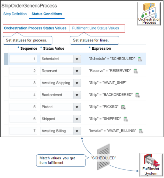

Set Up Statuses
Set up statuses.
Note
  • Different fulfillment systems might use different status values.
  • Set up statuses for your orchestration process so they match the values that your fulfillment system uses. This way, the fulfillment system understands values that the orchestration process sends, and the process knows how to handle values it receives.
    For example, fulfillment system x might use SCHEDULED, and system y might use FULFILLMENT_SCHEDULED. Add values to handle both systems.
  • You can also set statuses for order lines.
