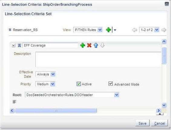

  4. In the Line-Selection Criteria dialog, add values:
    dialog Line-Selection Criteria
    Use tree mode to include an extensible flexfield in the root hierarchy of an orchestration rule. The hierarchy includes extensible flexfield variables so it isn't necessary to add more tests when you define the hierarchy.

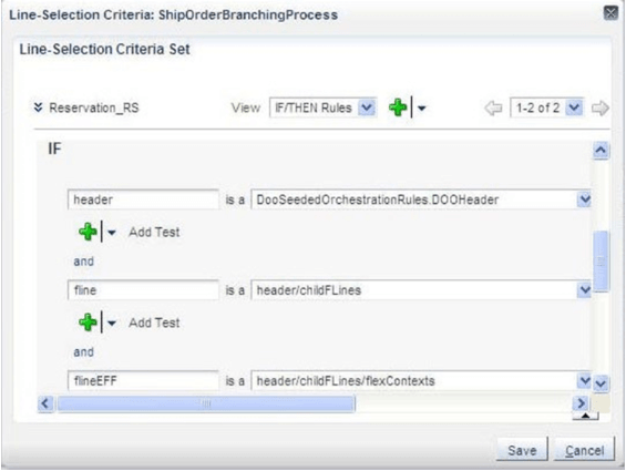

  5. Define IF statements:
    • header is a DOOSeededOrchestrationRules.DOOHeader
    • fline is a header/childFlines
    • flineEFF is a header/childFLines/flexContexts
    where
    • header is a variable that stores the order header.
    • fline is a variable that stores the order line.
    • flineEFF is a variable that stores the extensible flexfield.
    For example:
    adding variables in dialog

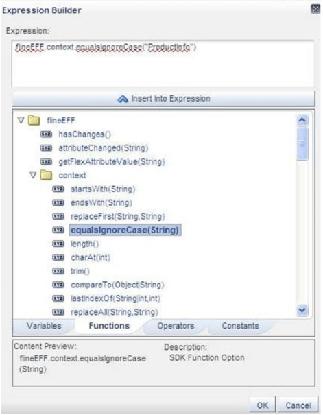

  6. Create an expression that looks up the extensible flexfield value in the tests:
    • flineEFF.context.equalsIgnoreCase("ProductInfo")
      For example:

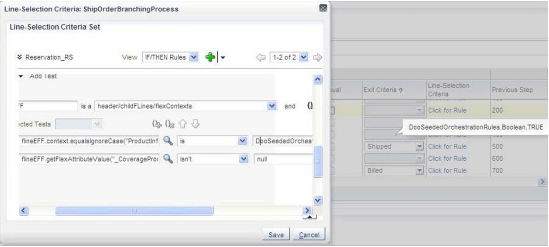

  7. Create tests:
    Code
    Description
    flineEFF.context.equalsIgnoreCase("ProductInfo") is DooSeededOrchestration Rules.Boolean.TRUE
    Make sure the item isn't a coverage item.
    flineEFF.getFlexAttributeValue("CoverageProduct") isn't null
    Make sure the value in the flexfield isn't empty.
    For example:
    adding tests to the rule

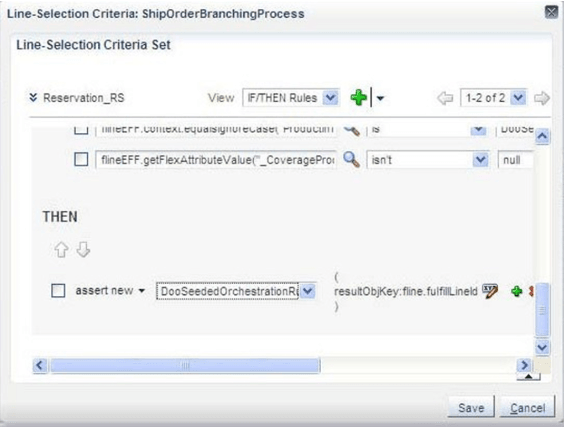

  8. Create an action:
    • Assert new DooSeededOrchestrationRules.Result(resultObjKey:fulfillLineId)
      This action creates the result to use for the order line that satisfies the If statement.
      In the Condition Browser, select the attribute. This attribute sets resultObjKey to the run-time value of the fulfillLineId.
      For example:
      creating the action
