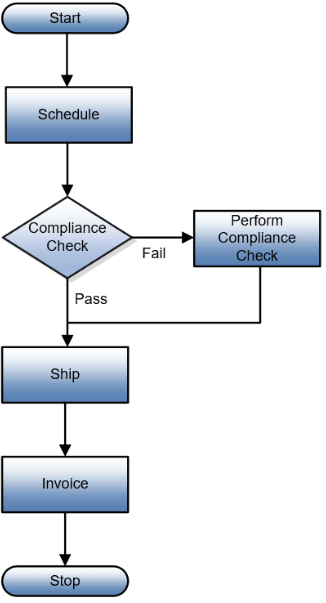

You will set up a line selection criteria in an orchestration process so it specifies which orchestration process steps to run for each order line. You set it up according to the value that the flexfield contains. You create this rule:
  • If the Export Compliance status is Not Passed for an order line, then manually examine the line. Send other order lines directly to shipping.
You will create this flow:
flow for Using Extensible Flexfields in Line-Selection Rules

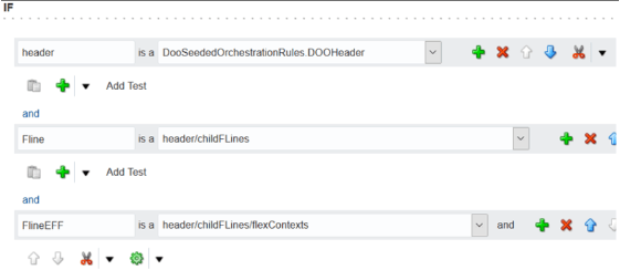

You will create this If statement. It establishes the object hierarchy:
statement that establishes the object hierarchy
Establish the object hierarchy.
  1. In the If area, delete the value in the field to the left of Is A, and then enter this value:
    Attribute
    Value
    Field to the left of Is A
    Header
  2. In the field to the right of Is A, set the value:
    Attribute
    Value
    Field to the right of Is A
    DooSeededOrchestrationRules.DOOHeader

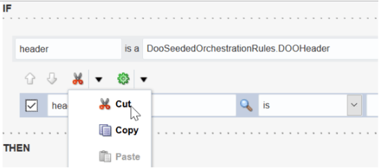

  3. Under the field that contains header, add a check mark to the option that selects the test, click Cut > Cut.
    For example:
    copying the test in the rule
    The hierarchy includes the extensible flexfield variables, so its not necessary to include tests when you define the hierarchy.
  4. Click Add Pattern.
  5. In the field to the left of Is A, enter the value:
    Attribute
    Value
    Fline
  6. In the field to the right of Is A, set the value:
    Attribute
    Value
    header/childFLines
  7. Click Add Pattern.
  8. In the field to the left of Is A, enter the value:
    Attribute
    Value
    FlineEFF
  9. In the field to the right of Is A, set the value:
    Attribute
    Value
    header/childFLines/flexContexts

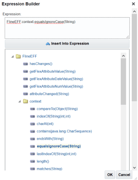

Select lines according to flexfield context.
  1. Under the pattern you just added, click Add Test.
    You will add the test criteria that identifies order lines that proceed through compliance testing. If the attributes you reference are optional, then you include null value checks to avoid a null pointer exception at run time.
  2. Click Left Value.
  3. In the Condition Browser, click Expression Builder.
  4. In the Expression Builder, click Functions, expand FLineEFF > Context, click equalsIgnoreCase(String), then click Insert Into Expression.
    For example:
    expanding the folders until you can view the functions of the context object
    To navigate the tree structure, expand the folders until you can view the functions of the context object. FlineEFF is the pattern you declared earlier.
    The context you expand is a fact in the FlineEFF pattern. It includes functions you can use to perform a variety of calculations. Therefore, the expression you create includes the pattern, fact, and function.

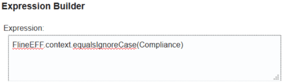

  5. In the window near the top of the dialog, replace the word String with the context for your extensible flexfield condition. In this example, replace String with Compliance.
    For example:
    defining context for your extensible flexfield condition
  6. Click OK > OK.

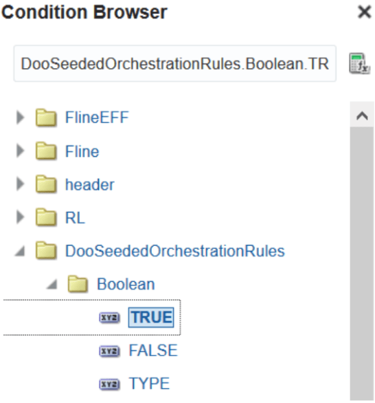

  7. Click Right Value.
  8. In the Condition Browser, expand DooSeededOrchestrationRules > Boolean, then click TRUE > OK.

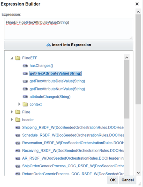

Select lines according to Compliance Status.
  1. In the test you just added, immediately to the right of the Right Value magnifying glass, click the down arrow, then click Simple Test.

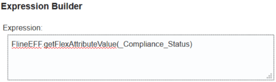

  4. In the Expression Builder, click Functions, click FlineEFF.getFlexAttributeValue(String), then click Insert Into Expression.
    For example:
    Selecting lines according to Compliance Status
  5. In the window near the top of the dialog, replace the word String with the name of the flexfield attribute.
    You must use an underscore to prefix the attribute name in a function. The attribute name is Compliance_Status, so you use _Compliance_Status.
    For example:
    adding status in expression
  6. Click OK > OK.

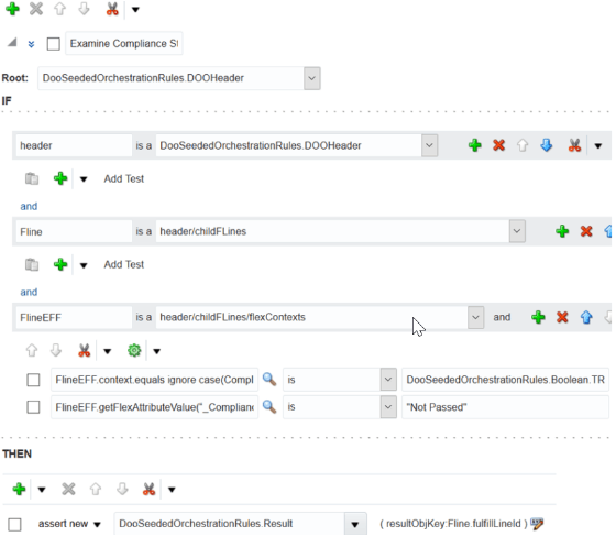

    Make sure your rule contains tests:
    Left Expression
    Operand
    Right Expression
    FLineEFF.context.equalsIgnoreCase("Compliance")
    Is
    DooSeededOrchestrationRules.Boolean.TRUE
    flineEFF.getFlexAttributeValue("_Compliance_Status")
    is
    "Not Passed"

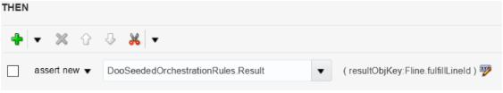

Identify the order line that requires manual examination.

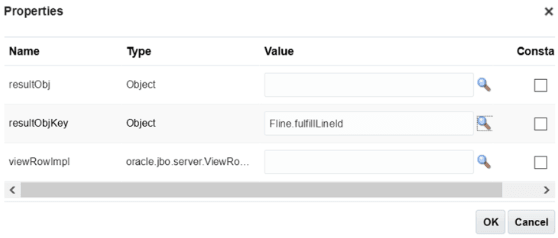

  1. In the Then area, click Add Action > Assert New.
  2. Click Select a Target > DooSeededOrchestrationRules.Result.
  3. Click Edit Properties.
  4. In the Properties dialog, in the resultObjKey row, click Value.
  5. In the Condition Browser, expand Fline, click fulfillLineID, then click OK.
  6. Make sure the Properties dialog looks like this:
    using the Properties dialog
  7. Click OK
