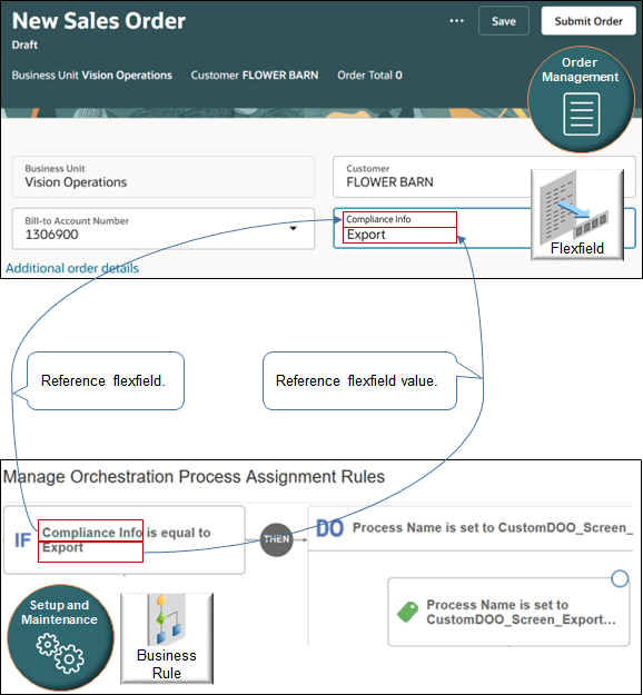

  • You do a needs analysis and decide to create the Trade Compliance Details flexfield, add it to the order header, then enter the value Export on the flexfield to indicate that the order's an export.
You will create an assignment rule that references the extensible flexfield:
assignment rule that references the extensible flexfield.
You will create this assignment rule:
  • If the Trade Compliance Details flexfield contains the value Export, then assign the order line to the Screen_Exports_for_Trade_Compliance orchestration process.

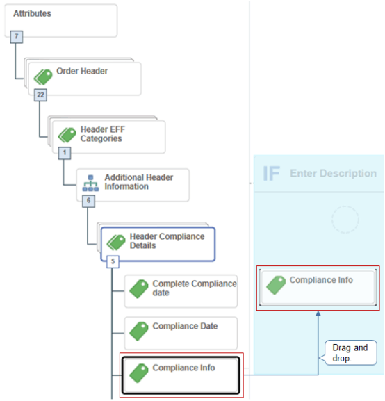

  3. Create the If statement:
    • Click in the If area to expand it.
    • On the Attributes tab, expand Order Header > Header EFF Categories > Additional Header Information > Header Compliance Details.
    • Click Compliance Info, drag it, then drop it into the IF area:
      dragging and dropping in the rule
    • In the Create Condition dialog, set the operator to Is Equal To.
    • Enter Export, then click OK.
