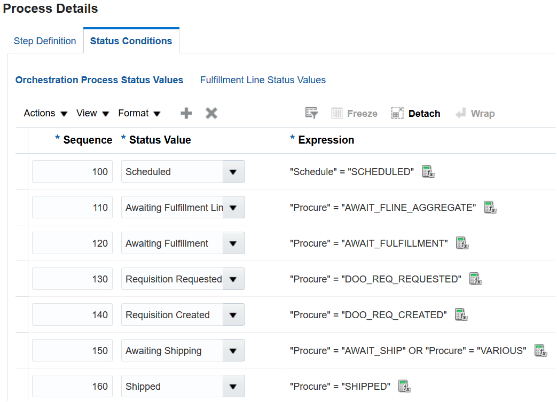

Set Up the Sequence for the Status Condition
Set up the sequence of status conditions so they match the logical progress of the status that the order line normally takes during the order line lifecycle. If more than one condition evaluates to true, then the orchestration process will set the order line status to the status value with the highest sequence number.
Here's an example:
how you can use the Sequence attribute in the Orchestration Process Status Values area on the Status Conditions tab of the Create Orchestration Process Definition page.
Note
  • You use the Sequence attribute in the Orchestration Process Status Values area on the Status Conditions tab of the Create Orchestration Process Definition page.
  • You set the sequence of the status conditions so they match the logical progress of the status. For example, Sequence 150 for status Awaiting Shipping happens before Sequence 160, status Shipped. If Awaiting Shipping and Shipped each evaluate to true, then the orchestration process sets the status to Shipped because 160 is higher than 150.
