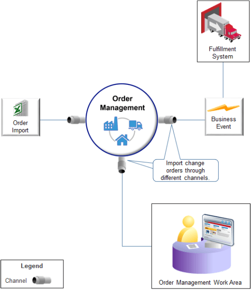

Import Change From Channel
You can import change orders through various channels:
flow of import change orders through various channels
Note
  • A channel can include an order capture system, fulfillment system, the Order Management work area, and so on.
  • Order Management cross-references, validates, and orchestrates the change in a way that's similar to how it does this work for a new sales order. If rules that control how to process a change exist, then Order Management applies them. You can use setup options to modify how Order Management does this processing.
  • Use the same Excel template that you use to import sales orders to import change orders. For details, see Import Orders Into Order Management.
  • Use the same REST API that you used to create the sales order when import a change order.
  • Use only one channel to make your change. For example, use the Order Management work area to create a revision, or use REST API, or use file-based import. Don't use the work area and REST API and file-based import. Using different channels causes confusion when attempting to identify the source of the change.
  • Order Management submits the change orders that it receives through REST API to order fulfillment. You can't submit a change order through REST API and keep it in Draft status. Order Management only keeps a sales order in Draft if an error happens in the change order.
  • Order Management doesn't update a sales order that's in Draft status.
  • If you use the Order Management work area, and if you must revise the order again, then use the work area again. Don't use REST API or file-based import to revise the order again.

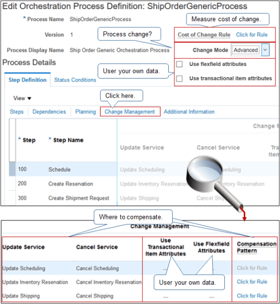

Orchestrate Fulfillment
Use the Edit Orchestration Process Definition page in the Setup and Maintenance work area. For details, see Set Up Orchestration Processes:
page Edit Orchestration Process Definition in work area Setup and Maintenance
You can administer these attributes:
Attribute
Description
Cost of Change Rule
A rule that you set up on an orchestration process that specifies the business cost your organization will incur as a result of processing the change.
Change Mode
An option that you set on an orchestration process. It determines when Order Management records the state of the process. It compares these states when it compensates the sales order.
Choose a value:
  • Advanced. Process change. Record the state of the orchestration process at each orchestration process step.
  • Simple. Process change only on the step that receives the change. Record the state of the orchestration process when it starts and at the step where the orchestration process receives the change.
  • None. Don't allow change. Don't record the state of the orchestration process.
Use Flexfield Attributes
An option that you can set on an orchestration process or orchestration process step that specifies whether to examine flexfield attributes when compensating the sales order.
If you enable this option, then Order Management examines flexfield attributes that the item references to determine whether it must compensate the orchestration process.
Assume you create a flexfield named Color. Assume the user changes the value of Color from Red to Blue. You can use Color during compensation to allow your fulfillment system to reschedule the order line so it ships a blue item instead of a red one.
Order Management disables Use Flexfield Attributes and Use Transactional Item Attributes on each predefined orchestration process, by default. You can't enable these options on a predefined orchestration process. However, you can create a copy of a predefined orchestration process, and then enable them on the copy.
An option that you set on an orchestration process or orchestration process step that specifies whether to examine transactional attributes when compensating a sales order. For details, see Manage Transactional Attributes.
Enable the Use Flexfields Attributes option and the Use Transactional Item Attributes option only if you will send these attributes to your fulfillment system during compensation.
Compensation Pattern
A rule that you set up on an orchestration process step that specifies the adjustment to make to the sales order when the order changes.
For example, if Order Management receives a change order that specifies to ship an item from a different warehouse during the Create Shipment step, then it runs the Cancel service and the Create service again.
If you don't specify a compensation pattern, then Order Management uses the predefined compensation pattern, by default. A predefined pattern uses Update, Cancel, or Create.
Reserve Supply
If you reserve or schedule an order line according to future supply, then consider whether your orchestration process needs the reserve step or the schedule step. For example, the reservation step examines supply that's currently available, and then reserves it to make sure your fulfillment system can fulfill the item. If you don't need to reserve supply, then don't include the reservation step. If you do need to reserve, then consider making the reservation step a manual step, for example, so the user must click a button, such as Reserve.
You can also add a pause step before the reserve or schedule step. The pause task can pause the orchestration process until the shipment is almost ready to ship, such as 12 hours before scheduled shipment. When the reservation step runs, it will provide a more accurate picture of supply that's available because it's closer to the ship date. Waiting to reserve supply in this way can also reduce the cost of holding inventory until it's time to ship.

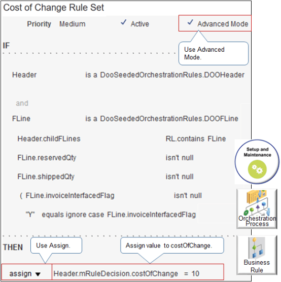

Set Up Rule for Cost of Change
Note
  • Set up a rule that measures the cost of change. If it's too high, then reject the change.
  • In the header area of the orchestration process, next to Cost of Change Rule, click Click for Rule.
  • Use Advanced Mode.
  • Use the Assign action.
  • Assign a numeric value to Header.mRuleDecision.costOfChange. For example:
    Header.mRuleDecision.costOfChange = 10

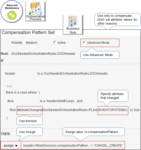

Set Up Compensation
Set Up Compensation
Note
  • Use a compensation rule only to compensate change. If you must also set the values for other attributes, then use an order management extension.
  • In the steps area of the orchestration process, in the step that you must compensate, in the Compensation Pattern column, click Click for Rule.
  • In the IF statement:
    • Use a change function, such as attributeChanged or Changed.
    • Specify the attribute that changed. For example, if the user changed the Item attribute, then use INVENTORYITEMID.
  • For example:
    Fline.attributeChanged(DooSeededOrchestrationRules.IFLine. INVENTORYITEMID)is true
    Get the list of attributes that you can specify. For details, see Entities and Attributes That You Can Use When You Integrate Order Management with Other Oracle Applications.
  • In the THEN statement:
    • For example:
      header.mRuleDecision.compensationPattern = "CANCEL_CREATE"
    • Assign a value:
      Value
      Description
      UPDATE
      Update the current fulfillment request with the latest attribute value.
      Each orchestration process comes predefined to use UPDATE, by default. If you don't specify a compensation pattern, and if the orchestration process detects a change, then it will send an update request to the fulfillment system.
      UPDATE_CREATE
      Update the current fulfillment request with the latest attribute value, and also create a new request.
      CANCEL_CREATE
      Cancel the current fulfillment request, and then create a new request that includes the latest attribute value.
      CANCEL_UPDATE
      Cancel the current fulfillment request, and then update another fulfillment request with the latest attribute value.
      CANCEL_UPDATE_CREATE
      Cancel the current fulfillment request, update another fulfillment request with the latest attribute value, and then create a new request that includes the latest attribute value.
      NOOP
      NOOP (No Operation). Don't do any compensation.

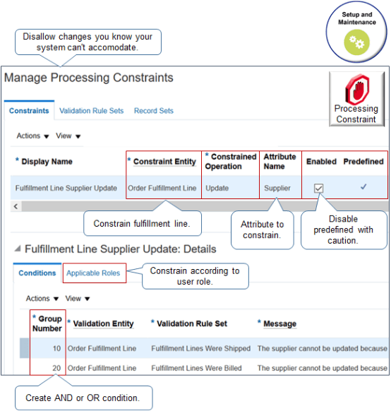

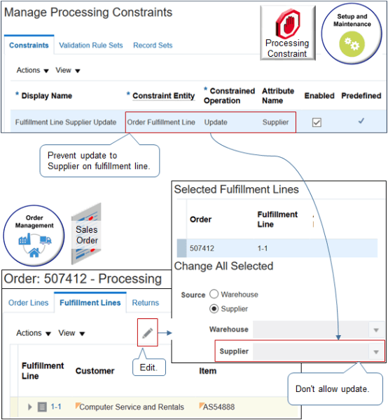

Constrain Change
Use a processing constraint:
  • Disallow change that you know your fulfillment system can't accommodate, such as changing the supplier for an item that requires significant lead time for the supplier to produce.
  • Make sure a channel doesn't make a change that your fulfillment system can't accommodate.
  • Make sure the user includes required attributes. Assume you add your own numeric attribute x for invoicing, and invoicing requires attribute x to calculate the invoice. You can use a constraint to make sure the user adds a value for x, and that the value is numeric.
  • If a constraint doesn't meet your business requirement, then use an order management extension to validate, then display a message or warning.
page Manage Processing Constraints
Note
  • Set the Constraint Entity attribute to Order Fulfillment Line.
  • If the Enabled attribute is active on a predefined constraint, then you can disable it. Disable a predefined constraint only after you make sure removing the constraint won't negatively affect your implementation.
  • Use the same value in the Group Number attribute to create an AND condition across constraints. For example, if you set Group Number to 10 for condition x, and Group Number to 10 for condition y, and if conditions x and y both evaluate to True, then Order Management applies the constraint.
  • Use different values in Group Number to create an OR condition. For example, if you set Group Number to 10 for condition x, and Group Number to 20 for condition y, and if condition x or y evaluates to True, then Order Management applies the constraint.
  • Use the Applicable Roles tab to specify the user roles that can or can't edit an attribute according to the constraint.
  • Use the Manage Processing Constraints page in the Setup and Maintenance work area.
  • For details, see Manage Processing Constraints.
For example:
flow of Managing Processing Constraints
Here's the logic that this constraint implements.
Prevent user from updating attribute Supplier on order line.
You set these values:
Attribute
Value
Constraint Entity
Constrained Operation
Update
Attribute Name
Supplier
Enabled
Contains a check mark

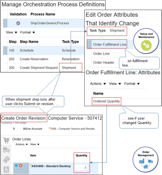

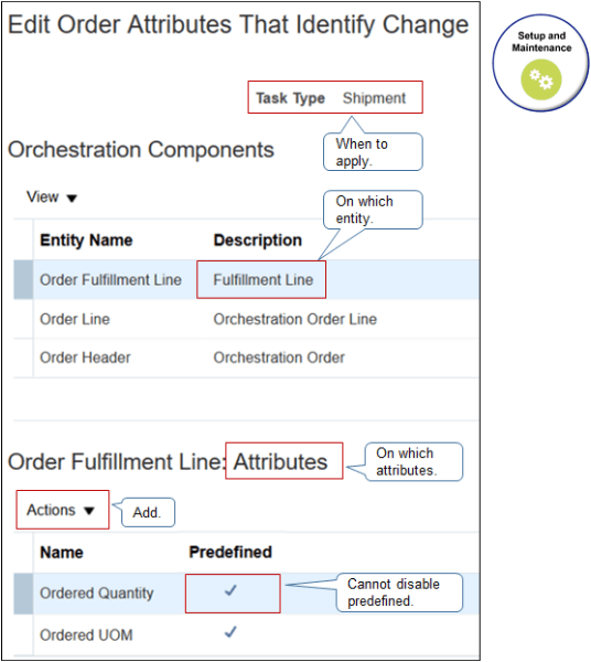

Manage Attributes That Identify Change
flow of Manage Attributes That Identify Change
You can set the Task Type attribute on an orchestration process step. The task type that you select determines the attributes that Order Management uses when it decides whether it must compensate the sales order for this step.
Order Management comes predefined to use a set of attributes for each predefined task type. You can't modify the predefined set up, but you can add more attributes. Order Management doesn't add these attributes to a new task type that you add, and it doesn't evaluate this task until you add these attributes. To add them, you must click Add All.
This example implements a condition.
If the user changes Quantity on order line, then perform compensation during shipping.
Note
  • The user creates a revision, clicks Submit, and then Order Management starts the orchestration process.
  • The orchestration process reaches a step that uses the Shipment task type, then examines the Manage Order Attributes That Identify Change page in the Setup and Maintenance work area to determine whether to process the change.
  • For details, see Manage Order Attributes That Identify Change.
For example:
setting attribute Task Type
Note
  • Set the Task Type attribute to a value, such as Schedule, Reservation, Shipment, and so on, to determine when to examine the change.
  • Specify an entity to determine where the attribute resides:
    • Order Fulfillment Line
    • Order Line
    • Order Header
  • Specify the attribute to examine, such as Ordered Quantity.
  • Use the Add action to add an attribute.
  • You can add a predefined attribute, such as Ordered Quantity, but you can't disable it.
