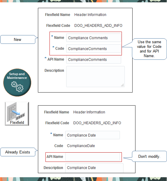

Create a new segment.
Use the same value for the Code attribute and the API Name attribute. This will simplify setup and maintenance.
You use API Name throughout the setup, such as when you integrate with a web service, business rule, business intelligence, and so on. You can't modify Code or API Name after you create the segment.
Modify a segment that already exists. Don't modify API Name.
The flexfield's logic examines API Name. If it's empty, then the logic uses the value in Code, so it isn't necessary to specify a value in API Name.
If you modify API Name, then your flexfield might fail with unexpected results at run time.

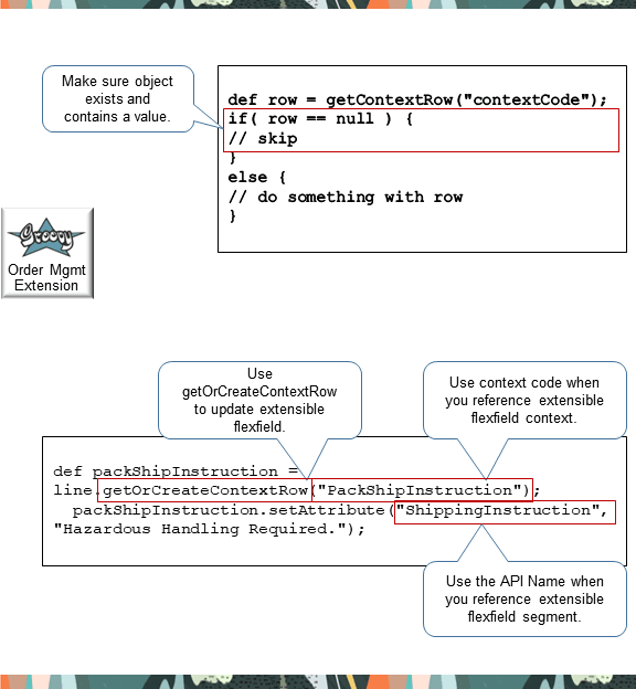

Use Order Management Extensions
guidelines when you use an extensible flexfield in an order management extension
Note
  • Include an If statement to make sure each context and segment that your extension references exists and contains a value. If you don't check for missing objects and empty values, then your extension might fail with unpredictable results.
  • Use the getOrCreateContextRow method to create or update a value in an extensible flexfield. If the object doesn't exist, then getOrCreateContextRow creates it, so it isn't necessary to determine whether the object exists before you use this method to do an update. Only use getContextRow to get a row.
  • Use Context Code when you reference the flexfield's context.
  • Use API Name when you reference the flexfield's segment. If you don't specify API Name when you set up the flexfield, then use Segment Code but with underscores ( _ ) instead of spaces ( ).
  • Your Groovy code must traverse the context and the segment to get all of the flexfield's data.
    Here's an example that uses a while statement to traverse all data.
    def complianceDetails = header.getOrCreateContextRow("ComplianceDetails");
    complianceDetails.setAttribute("_ComplianceReason", "This has been set by pre submit extension.");
    def lines = header.getAttribute("Lines");
    while( lines.hasNext() ) {
      def line = lines.next();
      def inventoryItemId = line.getAttribute("ProductIdentifier");
      def orgId = line.getAttribute("InventoryOrganizationIdentifier");
      def item = getItem(inventoryItemId, orgId);
      String hazardous = item.getAttribute("HazardousMaterialFlag");
      def packShipInstruction = line.getOrCreateContextRow("PackShipInstruction");
      if( "Y".equals(hazardous) ) {
          // get details for fulfill line context PackShipInstruction
          packShipInstruction.setAttribute("_ShippingInstruction", "Hazardous Handling Required.");

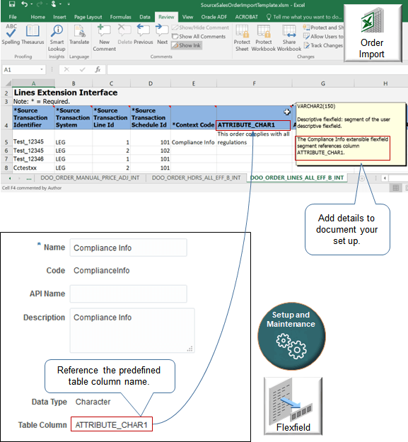

Use File Based Data Import
Use these guidelines when you use the order import template to import data for an extensible flexfield:
  • Assign each segment's Table Column attribute so it references the correct column in the order import template.
  • Use the DOO_ORDER_HDRS_ALL_EFF_B_INT worksheet to capture details for order headers.
  • Use the DOO_ORDER_LINES_ALL_EFF_B_INT worksheet to capture details for order lines.
  • Use columns, such as ATTRIBUTE_CHAR1, to capture details for each attribute.
  • Don't modify worksheet names or column names. Instead, add a comment.
  • Add a comment in Excel to document your set up.

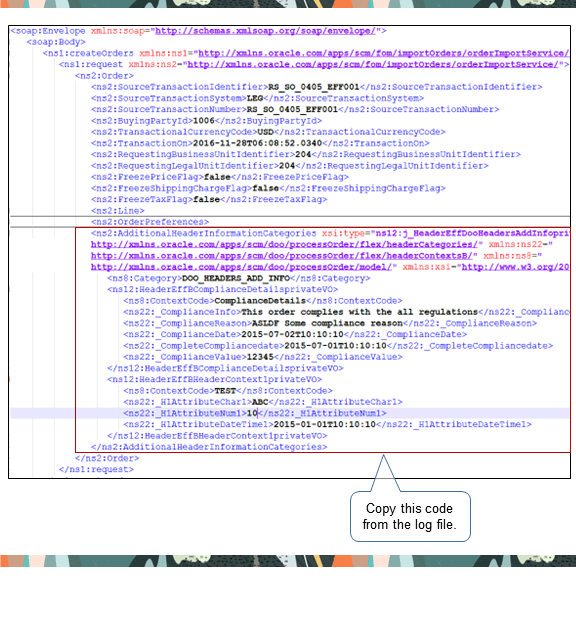

Use Web Services
Add your flexfield's details to the web service payload:
  • Use the Receive Fulfillment Task Response Service web service with all task types. Use the DooTaskFulfillOrderResponseInterfaceComposite composite.
  • Run the Publish Extensible Flexfield Attributes scheduled process.
  • Copy extensible flexfield data from the log file that the scheduled process creates into the XSD file that contains your payload. Copy this data onto each object that needs flexfield data. This approach helps to keep your channel system synchronized with your set up in Oracle Order Management.
  • Use the import service from Application Development Framework (ADF). Don't use the SOA (Service Oriented Architecture) import service.
This example payload copies one section of code from the log file into the XSD file:
payload to copy one section of code from the log file into the XSD file
See Guidelines for Using REST API, Web Services, and FBDI to Integrate Order Management.

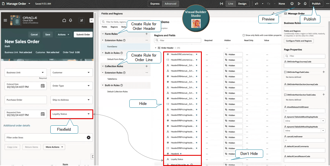

Display Your Flexfield
If you want to display a flexfield directly on the order header, then you must use Visual Builder Studio:
display
For critical details, see the Create Order - Business Rules video. The flexfield discussion starts at 3:50.
Here's a summary:
  1. Set up your flexfield in the Setup and Maintenance work area.
  2. Open Visual Builder Studio. For details, see Access Visual Builder Studio.
  3. Click Configure Fields and Regions.
  4. Create a regular form rule.
  5. Expand the Order Header entity.
  6. Click the Hidden column on the additionalInformation element, then click Visible By Default.
  7. Expand Global Data Elements and DOO_HEADERS_ADD_INFO under additionalInformation, then set all of their child elements to Always Hidden except for your flexfield. Make sure your flexfield is visible.
  8. As an option, use the Conditions to specify when to display your flexfield. For example, display it only if the Business Unit attribute contains Vision Operations.
  9. Remove any pop up blockers on your browser, then click Preview to make sure the flexfield displays as you expect it to.
  10. If all looks good, click Publish at the top of the page.
If you want to display the flexfield on a dialog instead of directly on the header, then you don't need to use Visual Builder Studio. Just use the DOO_HEADERS_ADD_INFO category when you set up your flexfield in Setup and Maintenance. To access it at run time, click Additional Order Details on the header and view the Additional Order Information section of the New Sales Order dialog.
Display Flexfields on Order Lines
You must use Visual Builder Studio to display a flexfield on the order line. Do the same steps that you use to add a flexfield to the header except create a collection rule instead of a form rule, and expand the Order Line (Table) entity.

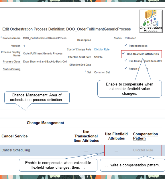

Manage Change
guidelines when you use an extensible flexfield while processing a change order
Identify your requirements for change management. For example, figure out whether the orchestration process must compensate when you change the value in your flexfield and the action to take when you compensate, such as schedule, call Oracle Receivables, and so on.
Set up the orchestration process differently depending on whether the value that it references changes any flexfield or only a specific one:
To Compensate Value For. . . . . .Enable the Use Flexfield Attributes Option . . .
Any extensible flexfield On the header of the orchestration process definition.
A specific extensible flexfield
In the Change Management section of the orchestration process definition.
Add it to the orchestration process step that references the flexfield. Also set up a compensation pattern on this step.
Use the compensation pattern to specify the action to do, such as Cancel, Create, Update, and so on, depending on the value that changes.
Your set up can send an update when a single value changes and skip sending an update when other values change. This approach provides more detailed control regarding the compensation that you do.
Here's an example compensation pattern:
pseudocode:
If segment3 changes, then cancel task x, and then recreate task x.
If segment4 changes, then do nothing.
If segment5 changes, then call an update service.
For a detailed example, see Compensate Sales Orders That Change.
To ignore changes to all flexfield values, make sure Use Flexfield Attributes for each step in the Change Management section isn't enabled.
Change management ignores each change that you make to a flexfield's value at run time when it's on the order header.

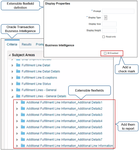

Use Reports and Analytics
Modify Reports
guidelines when you use an extensible flexfield in a report.
You can use the Sales Order report when you create or view a sales order.
Add the flexfield's data to the report:
  1. Install Oracle Analytics Publisher Desktop,
  2. Use the Edit Sales Order Report action in Oracle Analytics Publisher. This action displays Sales Order Report in rich text format so you can modify it.
  3. Right-click a field, then click Copy.
  4. Use Oracle Analytics Publisher Properties to specify the source that the report uses to display data for the field. Use this format:

Oracle Transaction Business Intelligence (OTBI) provides analytic reporting. You can display flexfield data in OTBI:
guidelines when you display extensible flexfield data in OTBI
Note
  • Enable the BI Enabled option when you set up your flexfield.
  • Run the Import Oracle Fusion Data Extensions for Transactional Business Intelligence scheduled process. This process updates OTBI so it displays your flexfield in area Subject Areas in OTBI. For details, see Overview of Flexfield Change Import.
  • Add your flexfield from Subject Areas into a report in OTBI.
  • OTBI uses this format:
    Category_Context
    For example:
    Additional Fulfillment Line Information_Additional Details1

What Happens to Flexfields When I Cancel Order Lines During Revision?
If you cancel an order line on a draft revision, and if you have an extensible flexfield on that line, then Order Management doesn't keep the flexfield's value after you submit the revision. Assume you set up an extensible flexfield named Update Reason on the order line and you use it to indicate why you changed the quantity on the line when you revise an order. You set it up so you can select one of these values at run time:
  1. Customer Request
  2. Insufficient Supply
  3. Damaged During Shipment
You revise the order, set the Update Reason to Customer Request, cancel the line, then submit the revision. You notice that the quantity is now zero but Update Reason is empty on the revision. This is expected behavior. If you're using the flexfield only to indicate a return reason, then we recommend you use the predefined Return Reason attribute instead.
