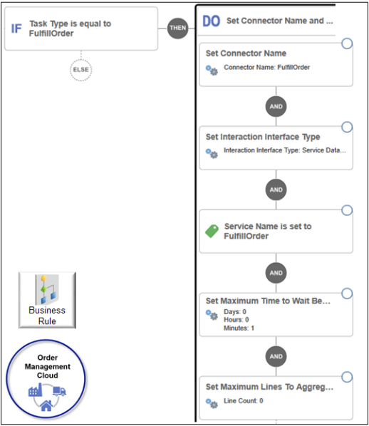

Route Sales Orders to eBusiness Suite
You will create a routing rule:
rule that Routes Sales Orders to eBusiness Suite.
Learn how to use the rules editor. For details, see Manage Routing Rules.
Route sales orders from Order Management to eBusiness Suite.
  1. Open the Manage External Interface Routing Rules for Sales Orders page.
    For details, see Overview of Using Business Rules With Order Management.
  2. On the Manage External Interface Routing Rules page, click Create New Rule, then set the values:
    Attribute
    Value
    Name
    Description
  3. In the If area, create a statement.
    If Task Type is equal to FulfillOrder
  4. In the Do area, create a statement for each attribute:
    Attribute
    Value
    Connector Name
    FulfillOrder
    Interaction Interface Type
    Service Data Object
    Service Name
    Is set to FulfillOrder
    Maximum Time to Wait Before Sending
    1 minute
    Maximum Lines to Aggregate and Send
    0
  5. Click Save and Close.
  6. Click the rule you just created. In the dialog that displays, set the values, then click Save and Close:
    Attribute
    Value
    Priority
    Highest
    Activate Rule
    Contains a check mark.

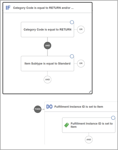

Route Items to eBusiness Suite
You will create a rule:
rule that Routes Items to eBusiness Suite.
Do it.
  1. On the Manage External Interface Routing Rules page, click Create New Rule, then set the values:
    Attribute
    Value
    Name
    Description
    Route sales orders that don't include a configured item from Order Management to eBusiness Suite.
  2. In the If area, create statements.
    If Category Code is equal to RETURN
    and
    Item Subtype is equal to Standard
  3. In the Do area, create a statement for the attribute:
    Attribute
    Value
    Fulfillment Instance ID
    Is set to Item
  4. Click Save and Close.
  5. Click the rule you just created. In the dialog that displays, set the values, and then click Save and Close:
    Attribute
    Value
    Priority
    Medium
    Activate Rule

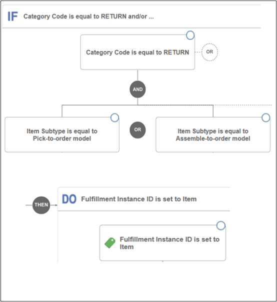

Route Configured Items to eBusiness Suite
rule that Routes Configured Items to eBusiness Suite.
Create the routing rule for the configured item.
  1. On the Manage External Interface Routing Rules page, click Create New Rule, then set these values:
    Attribute
    Value
    Name
    Description
    Route sales orders that include a configured item from Order Management to eBusiness Suite.
    and
    Item Subtype is equal to Pick-to-order model
    or
    Item Subtype is equal to Assemble-to-order model
    Attribute
    Value
    Is set to Item
  5. Click the rule you just created. In the dialog that displays, set the values, then click Save and Close:
    Attribute
    Value
    Priority
    Medium
    Activate Rule

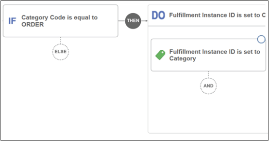

  2. In the If area, create a statement.
    If Category Code is equal to ORDER
    Tip:
    Click New Condition, then, in the Create Condition dialog, enter Category, wait for the list to display values, then click Category Code (Order Fulfill Line).
    Attribute
    Value
    Is set to Category
    Click New Action > Set a Value. In the Create Action dialog, set the top value to Fulfillment Instance ID, then, below is set to, click Attribute, then enter Category. Using this technique displays attributes that are already defined, and helps to make sure you choose an attribute that the rule can use.

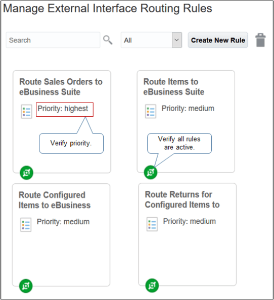

  6. Verify that you set the Route Sales Orders to eBusiness Suite rule to the highest priority, and that you activated each of your rules:
    rule that Routes Sales Orders to eBusiness Suite to the highest priority.
