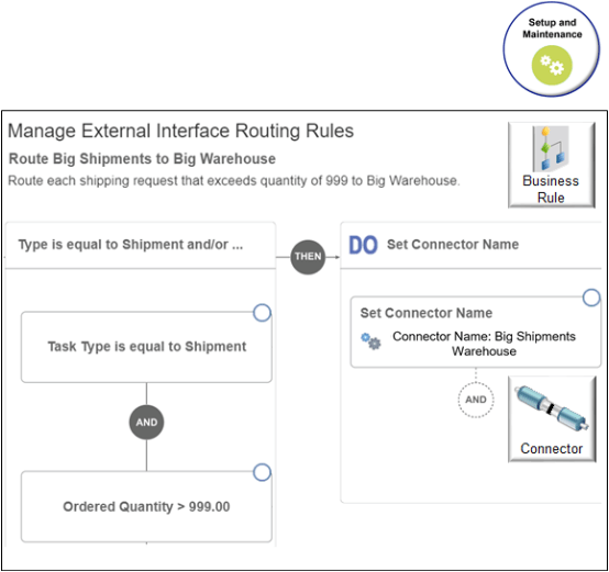

Assume you must create a routing rule that implements a condition:
  • If task type is Shipment, and if quantity is 1000 or more, then route shipment request to Big Warehouse.
Here's the rule you will create:

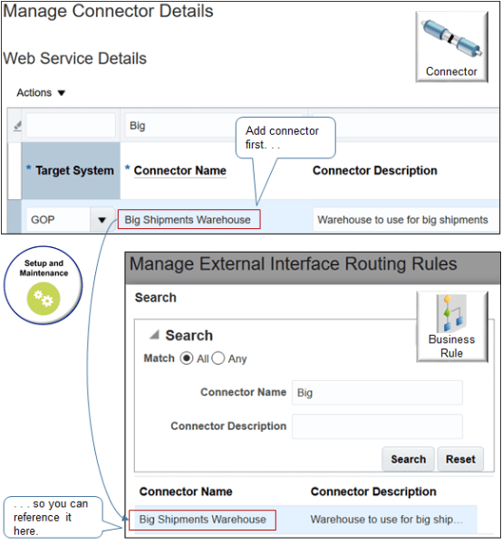

Set Up Connector
Set the values:
Attribute
Value
Name
Big Shipments Warehouse
Description
Route each shipping request that exceeds a quantity of 999 to the Big Shipments warehouse.
For details, see Connect Order Management to Your Fulfillment System.
Create the If Statement
  1. Go to the Setup and Maintenance work area, then go to the Manage External Integration Routing Rules for Sales Orders task.
  2. On the Manage External Interface Routing Rules page, click Create New Rule, then set the values:
    Attribute
    Value
    Name
    Route Big Shipments to Big Warehouse
    Description
    Route each shipping request that exceeds quantity of 999 to Big Warehouse.
  3. Add the If condition:
    • Click New Condition.
    • In the Create Condition dialog, enter Task, wait a moment, then click Task Type (Order Header).
    • Click Search.
    • In the Search dialog, enter Shipment, then click Search > OK > OK.
  4. Add the And condition:
    • Click And.
    • In the Create Condition dialog, enter Quantity, wait a moment, then click Ordered Quantity (Order Fulfill Line).
    • Change = to >.
    • Enter 999, then click OK.
Create the Then Statement
  1. On the flowchart, click Then > Do > New Action > Perform an Action.
  2. In the Create Action dialog, choose Set Connector Name, then click Search.
  3. In the Search dialog, set the value, then click Search > OK > OK:
    Attribute
    Value
    Connector Name
    Note that the Manage Connector Details page defines the connectors that the Search dialog displays on the Manage External Interface Routing Rules page:
  4. Click Save and Close.
  5. On the Manage External Interface Routing Rules page, click your rule.
  6. In the dialog that displays, add a check mark to Activate Rule, then click Save and Close > Publish.
