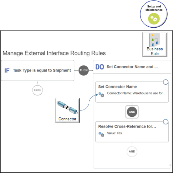

- Create a routing rule that implements this logic:
- If the task type is Shipment, and if the quantity is 1000 or more, then
route the shipment request to Big Warehouse.
For details, see Route Requests from Order Management to Fulfillment Systems.
- On the Manage External Interface Routing Rules page, open your rule for editing, then, in the flowchart, click And > Perform an Action.
- In the Create Action dialog, select Resolve Cross-Reference for Customer.
- Select a value, then click OK. For this example, select
No:
Value Description Yes Use a cross-reference from an Oracle Application. No Use a cross-reference from the fulfillment system. - Click Save and Close, then publish your rule.
