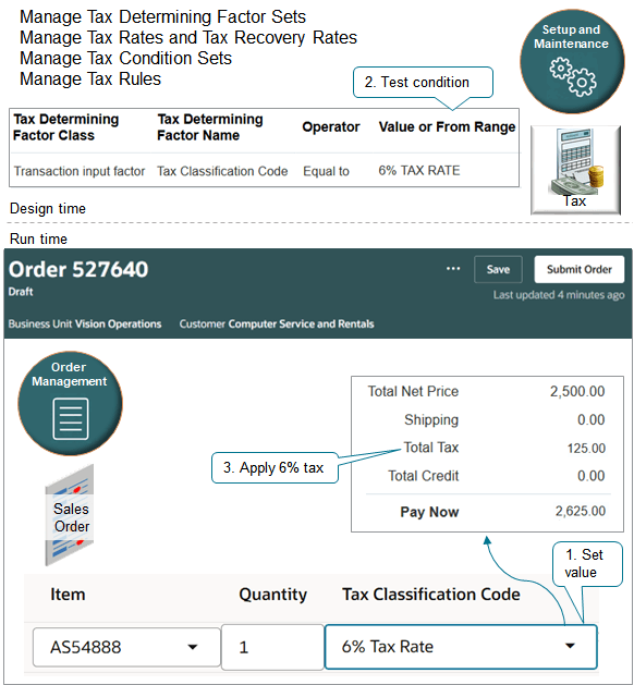

The Order Entry Specialist can use the Tax Classification Code attribute on the order line to set the tax rate to apply for the line. Tax Classification Code is just a fancy name for a tax rate. For example, if the Order Entry Specialist sets the Tax Classification Code to 4%, then Order Management ignores any other tax that you have set up for the sales order, such as according to the customer site, and applies a 4% tax instead:

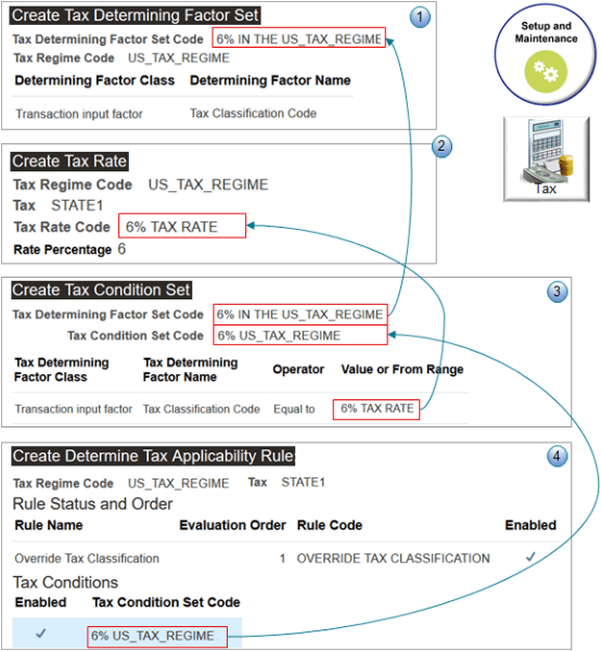

Here's the pseudocode for the condition you set up in this topic:
  • If the Order Entry Specialist sets the value of the Tax Classification Code attribute on the order line to 6% TAX RATE, then use the 6% IN THE US_TAX_REGIME factor set.
4
Manage Tax Rules
Specify the sequence to use when evaluating conditions and rules if you have more than one condition or more than one rule.
This task is most useful in more complex implementations where you have more than one condition or rule. However, you must create a tax rule even if you only have one condition and one rule.
Here's what happens at run time:
An Order Entry Specialist creates a sales order in the Order Management work area, adds an order line, and sets a value in the Tax Classification Code attribute. The adjustment is an input from a transaction, the determining factor is the Tax Classification Code attribute, and the value is 6% Tax Rate, so the condition evaluates to true, and Order Management applies the 6% rate to sales order total.

  1. Create the factor set.
  2. Create the tax rate.
  3. Create the condition set.
  4. Create the tax rule.
  5. Collect data.
  6. Test your set up.

Create the Factor Set
  1. Go to the Setup and Maintenance work area, then go to the Manage Tax Determining Factor Sets task.
  2. On the Manage Tax Determining Factor Sets page, click Create.
  3. On the Create Tax Determining Factor Set page, set the values:
    Attribute
    Value
    Tax Determining Factor Set Code
    6% in the US_TAX_REGIME
    Tax Determining Factor Set Name
    Set Usage
    Tax Rules
    Tax Regime Code
    US_TAX_REGIME
  4. In the Associate Tax Determining Factors area, set the values, then click Save and Close > Done:
    Attribute
    Value
    Determining Factor Class
    Transaction Input Factor
    You can select from a wide variety of classes, such as geography, party, inventory, transaction, and so on.
    Transaction Input Factor specifies that you will use the input from a transaction to set the tax rate. A sales order is a type of transaction.
    Determining Factor Name
    Here you're specifying the name of the attribute in the sales order that the Order Entry Specialist will use to adjust the tax rate.
Create the Tax Rate
  1. On the setup page, go to the Manage Tax Rates and Tax Recovery Rates task.
  2. On the Manage Tax Rates and Tax Recovery Rates page, click Actions > Create.
  3. On the Create Tax Rate page, set values:
    Attribute
    Value
    Tax Regime Code
    US_TAX_REGIME
    Configuration Owner
    Global Configuration Owner
    Tax
    STATE1
    Tax Status Code
    STANDARD
    Tax Jurisdiction Code
    Tax Rate Code
    6% Tax Rate
    Tax Rate Type
    Percentage
    Order to Cash
    Procure to Pay
    Expenses
    Contains a check mark.
  4. In the Rate Periods area, set the values, then click Save and Close > Done:
    Attribute
    Value
    Rate Percentage
    6
    Set as Default Rate
    Doesn't contain a check mark.
Create the Condition Set
  1. On the setup page, go to the Manage Tax Condition Sets task.
  2. On the Manage Tax Condition Sets page, click Create.
  3. On the Create Tax Condition Sets page, set the values:
    Attribute
    Value
    Tax Condition Set Code
    6% US_TAX_REGIME
    Tax Condition Set Name
    6% US_TAX_REGIME
  4. In the Tax Condition Set Details area, set the values, then click Save and Close > Done:
    Attribute
    Value
    Tax Determining Factor Class
    Tax Determining Factor Name
    Operator
    Equal To
    Value or Start From Range
    6% Tax Rate
Create the Tax Rule
  1. On the setup page, go to the Manage Tax Rules task.
  2. On the Manage Tax Rules page, click Actions > Create.
  3. On the Create Determine Tax Applicability Rule page, set the values:
    Attribute
    Value
    Configuration Owner
    Tax Regime Code
    US_TAX_REGIME
    Tax
    STATE1
    Rule Code
    Override Tax Classification
    Rule Name
  4. In the Tax Determining Factor Set area, in the Code attribute, set the value, then click Next:
    Attribute
    Value
    Code
  5. On the Create Determine Tax Applicability Rule Override Tax Classification page, in the Tax Condition Set area, set the values, then click Save and Next:
    Attribute
    Value
    6% US_TAX_REGIME
    New Condition Set Order
    1
    Result
    Applicable
    Enabled
  6. On the Edit Determine Tax Applicability Rule page, in the Rule Status and Order area, add a check mark to the Enabled attribute, then click Submit > Done.

Test Your Set Up
  1. Go to the Order Management work area and create a sales order:
    Attribute
    Value
    Customer
    Computer Service and Rentals
    Business Unit
    Vision Operations
    Ship-to Address
    2164 Broadway, Tempe, AZ, 85282
  2. Add an order line:
    Attribute
    Value
    Item
    AS54888
    Quantity
    1
    Amount
    2,500
  3. Click the total at the top of the sales order, then verify that the tax rate is 5%, which is the STD-DEFAULT rate you set up according to the ship-to address:
    Attribute
    Value
    Total List Price
    2,500.00
    Discount
    0.00
    Total Net Price
    2,500.00
    Shipping
    0.00
    Total Tax
    125.00
    125 is 5% of 2,500, so this rate is correct.
    Total Credit
    0.00
    Pay Now
    2,625.00
  4. Set the Tax Classification Code attribute to 6% Tax Rate.
  5. Click Additional order details, examine the order total, then verify that the tax rate is 6%:
    Attribute
    Value
    Total List Price
    2,500.00
    Discount
    0.00
    Total Net Price
    2,500.00
    Shipping
    0.00
    Total Tax
    150.00
    150 is 6% of 2,500, so this rate is correct.
    Total Credit
    0.00
    Pay Now
    2,650.00
