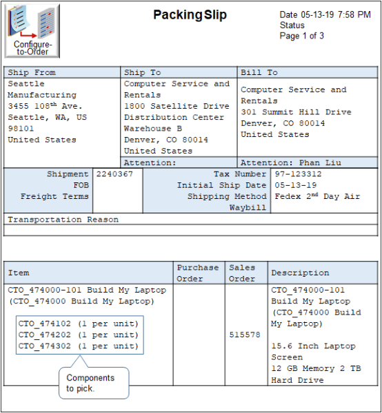

  3. Examine the Print Packing Slip Report:
    • Click Print Packing Slip Report.
      The Packing Slip Report displays the details of the configured item.
    • Click the output name in the Output area of the Print Packing slip report.

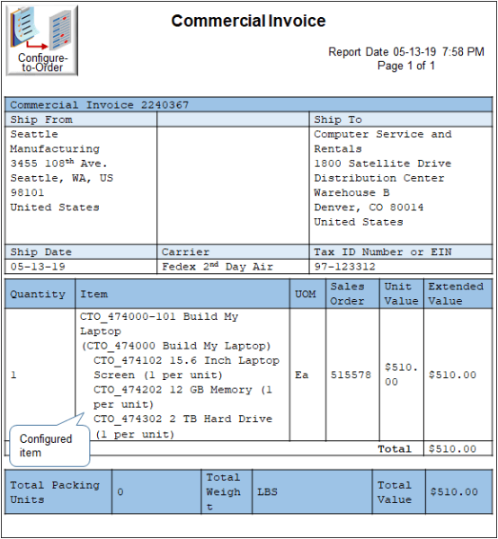

      Ship confirm doesn't automatically submit the Commercial Invoice. You must manually submit it.
  4. Go to the Scheduled Processes page, then click Schedule New Process.
  5. On the Schedule New Process page, set the value:
    Attribute
    Value
    Name
    Print Commercial Invoice Report
  6. In the Process Details dialog, set the values, then click Submit:
    • Enter the ship-from organization, such as 002 Atlanta.
    • Enter the same shipment number you entered earlier in this procedure when you used the Parameters section of the dialog.
  7. Wait for the status to change to Succeeded.
  8. Examine the invoice:
    Examine the invoice.
    The invoice includes:
    • The configured item, CTO_474000-101 Build My Laptop
    • The model, CTO_474000 Build My Laptop
    • Each option your user chose, such as CTO_474102 15.6 Inch Laptop Screen (1 per unit)
Note
  • It isn't necessary to do any more set up to get and display the invoice.
  • A web service in Supply Chain Orchestration gets details for this sales view when you ship confirm the sales order.
  • You can view the model and options for the configured item on the commercial invoice and the packing slip.
  • The invoice displays the quantity for each component in the configured item assuming that the configured item quantity is one.
  • You don't have to do any special document setup for configured items.
Here's an example of the packing slip:
example of the packing slip.
