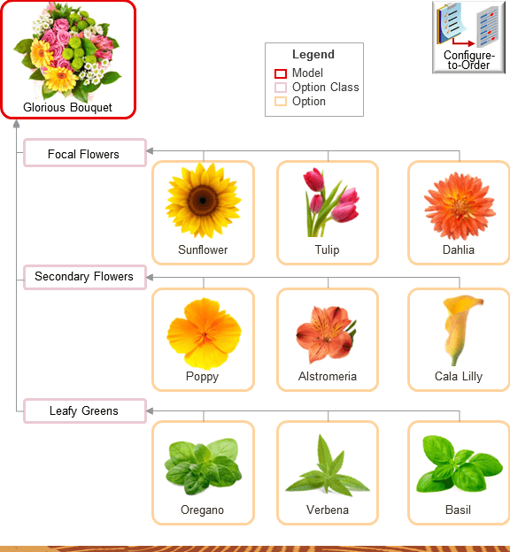

Assume you set up this assemble-to-order configuration model:
Assume you set up this assemble-to-order configuration model:text
Next, you go to the Order Management work area:
  1. You add the bouquet to an order line.
  2. The work area displays this structure, and you select your options:
    Glorious Bouquet
      Focal Flowers
        Sunflower
        Tulip
        Dahlia
      Secondary Flowers
        California Poppy
        Alstroemeria
        Cala Lilly
      Leafy Greens
        Oregano
        Verbena
        Basil
    Italics indicate the options that you selected.
