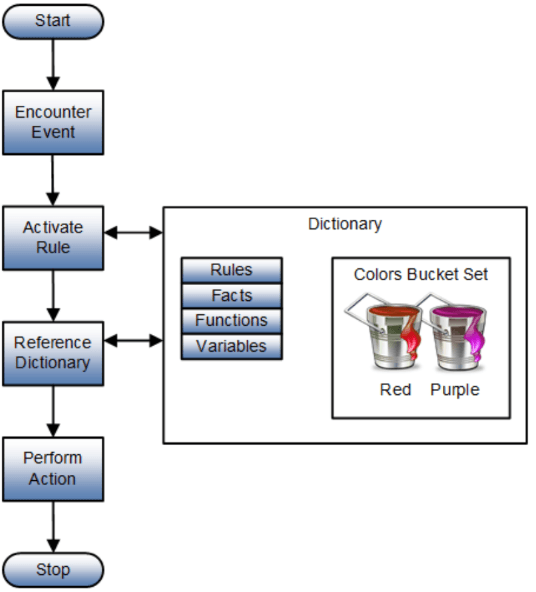

Assume you create a Colors bucket set that includes string values of red and purple. You can write a rule for each color. You can also write one rule for blue and another rule for purple:
how a business rule uses a bucket set

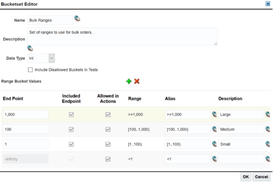

Here's an example bucket set that groups ranges of values into a large, a medium, or a small bucket:
example that specifies ranges of values into a large, a medium, and a small bucket
