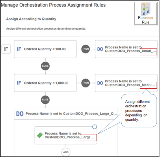

You will create this rule:
assignment rule you will create

Create the Assignment Rule
  1. Go to the Setup and Maintenance work area, then go to the Manage Process Assignment Rules for Sales Orders task.
  2. On the Manage Orchestration Process Assignment Rules page, click Create New Rule, then set the values:
    Attribute
    Value
    Name
    Assign According to Quantity
    Description
    Assign different orchestration processes depending on quantity.
Create the Small Order Condition
  1. Create the If statement:
    • Click New Condition.
    • In the Create Condition dialog, enter ordered, wait a moment, then click Ordered Quantity (Order Fulfill Line).
      Order Fulfill Line indicates that the attribute resides on the order line.
    • Set the operator to less than ( < ).
    • Enter 100, then click OK.
  2. Create the Do statement:
    • Click Then > Do > New Action.
    • In Create Action dialog, enter process, wait a moment, then click Process Name (Order Fulfill Line).
      The phrase Order Fulfill Line indicates that the orchestration process that you set will process order lines.
  3. Search for your orchestration process:
    • Click Search > Advanced.
    • Set Process Name to Contains.
    • Enter Process_Small_Orders.
      The search is case sensitive.
    • Click Search.
      If you didn't deploy your orchestration process, then the search won't find it.
    • Click the row in the search results.
    • Click OK.
    • In the Create Action dialog, click OK.
Create the Medium Order Condition
Do the same steps that you used when you created the small order condition, but with these differences:
  • Click Else > If.
  • In the If statement, enter 1000.
  • In the Do statement, set Process Name to Process_Medium_Orders.
Create the Large Order Condition
Do the same steps that you used when you created the medium order condition, but with these differences:
  • Click Else > Do.
  • Don't create an If statement.
Make sure you activate and publish your rule.
