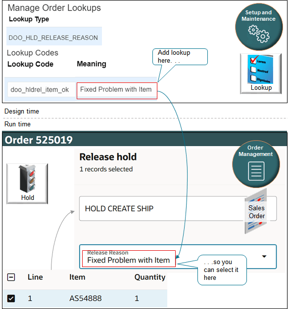

Create a Release Reason
Create a reason that your user can choose to indicate why they released the hold.
Try it.
In the Setup and Maintenance work area, go to the task.
Offering: Order Management
Functional Area: Orders
Task: Manage Order Lookups
On the Manage Order Lookups page, enter the value, then click Search.
Attribute
Value
Lookup Type
DOO_HLD_RELEASE_REASON
In the DOO_HLD_RELEASE_REASON: Lookup Codes area, click Actions > New then set the values.
Attribute
Value
Lookup Code
doo_hldrel_item_ok
Display Sequence
1
Start Date
The current date.
End Date
One week from today.
Meaning
Fixed Problem with Item
Description
Fixed the problem with the item.
Click Save and Close.
